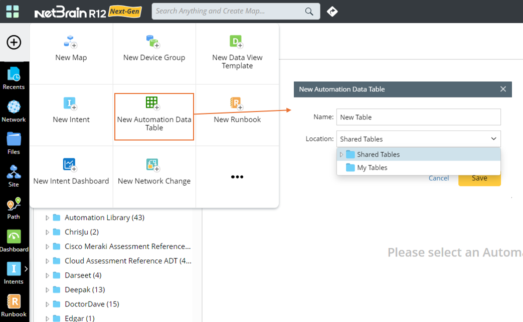

  1. Go to the   menu, then click New Automation Data Table widget. In the popup dialog, define table name and select location to store the table.

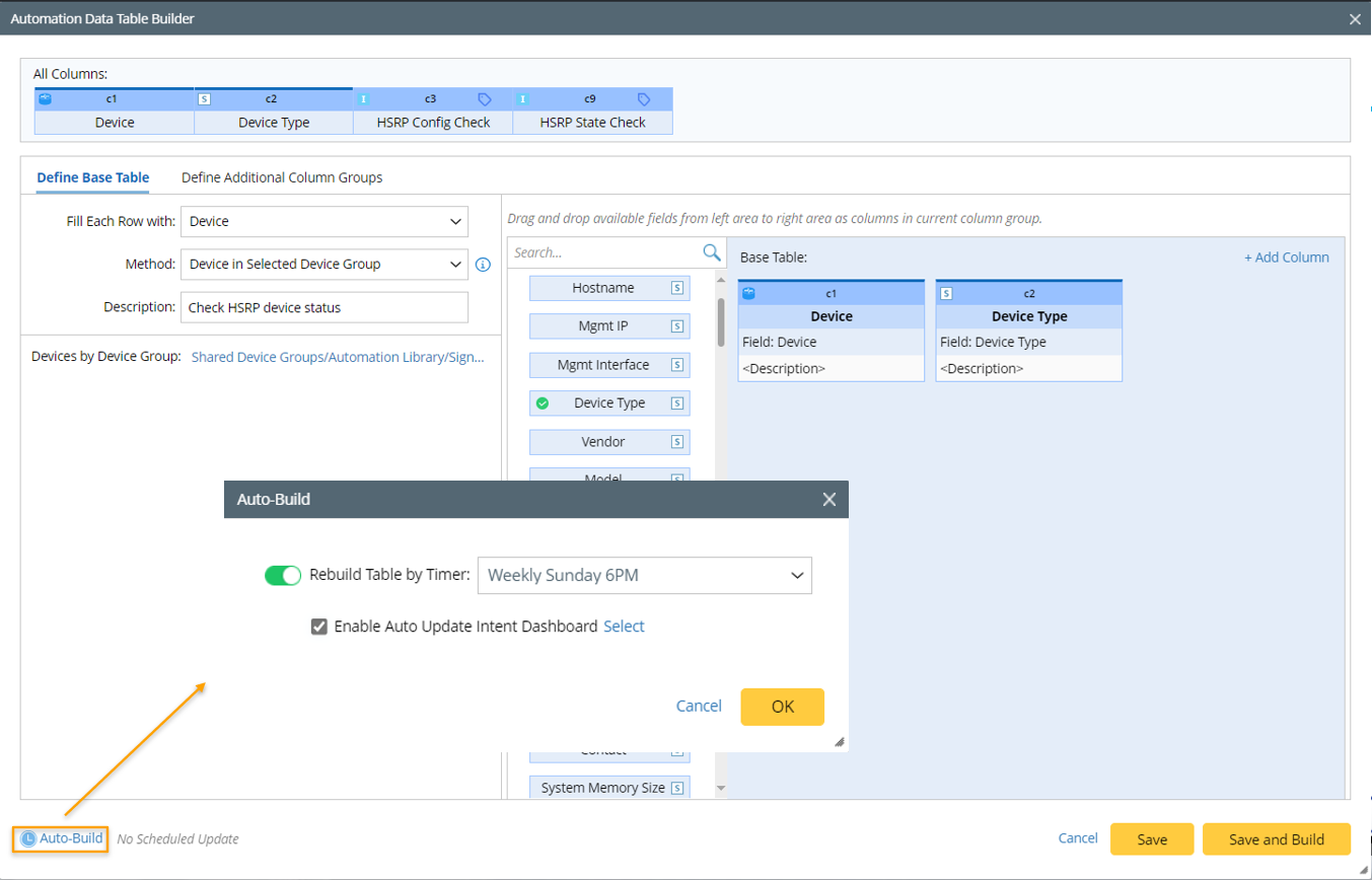

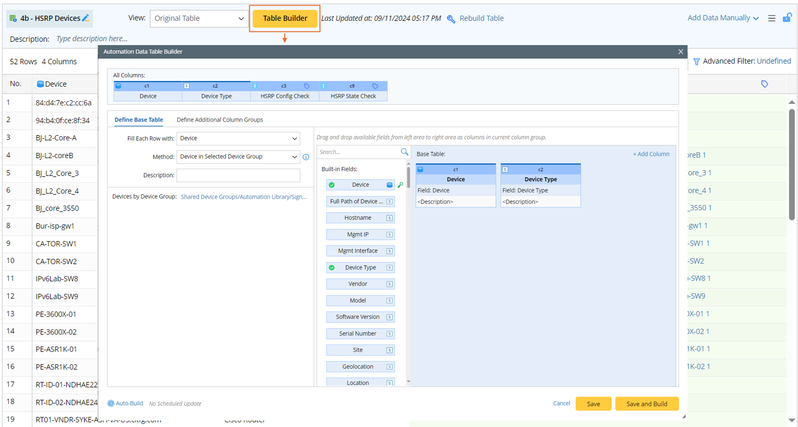

  2. Go to Table Builder> Define Base Table to build a base table containing data fields to include automation asset data to be used.

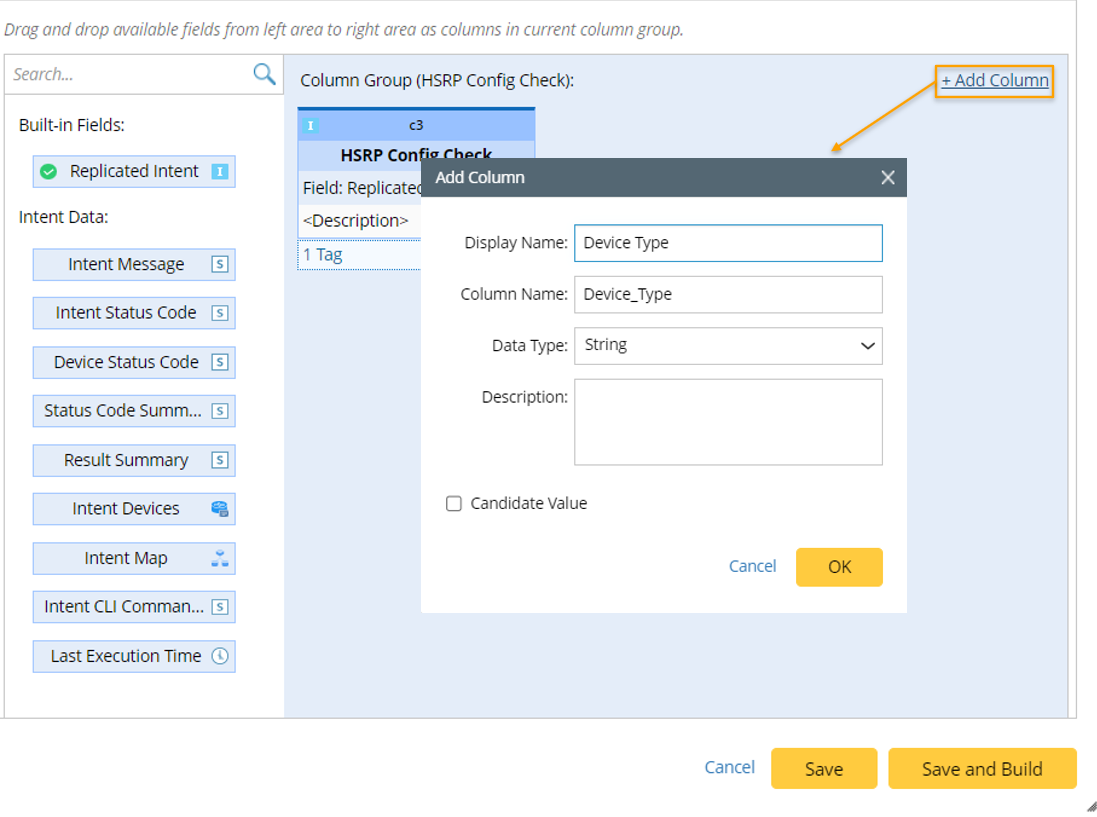

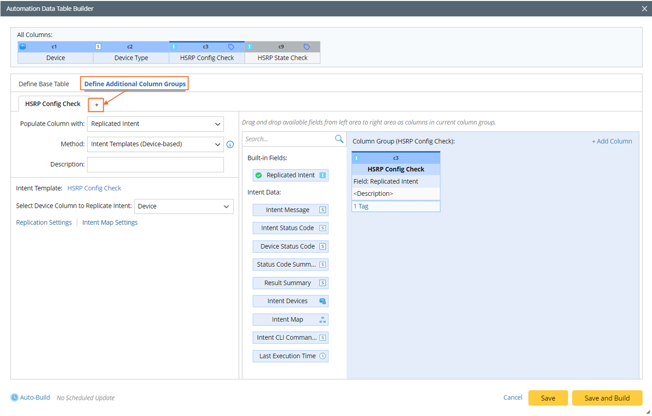

  3. Go to Table Builder > Define Additional Column Groups, then click  to create column groups to enrich the base table data.
  4. Go to Automation Data Table Builder (Auto-Build) to schedule to update ADT data periodically.
  5.  Go to Automation Data Table Manager (Add Column) to manually add or adjust the table data.
