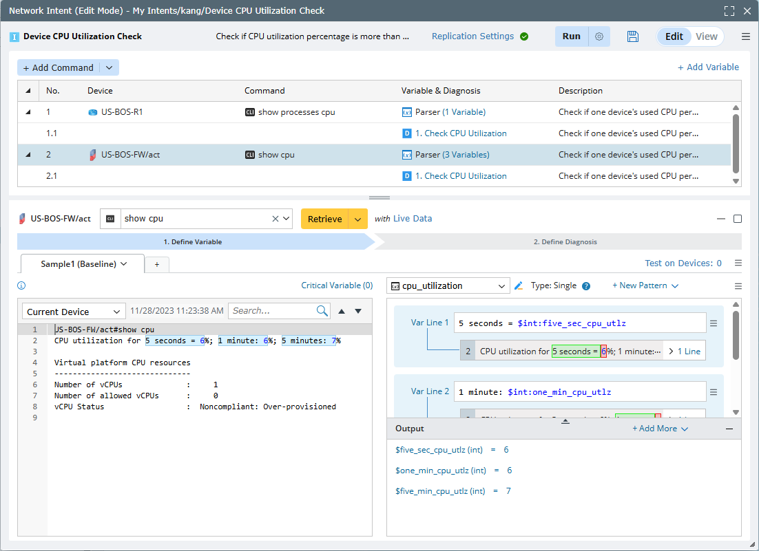

Users can define an intent in the intent editor using the following main components. They can also define intents through auto intent and quick intent, or create a special intent type called map intent.

NI takes the device configurations and CLI/API/SNMP commands as the input and leverages Visual Parser, a UI-based no-code parser, to define the variables and the diagnosis logic for these variables.
Information Note: Users can quickly add a diagnosis with the template without deep knowledge of diagnosis definition.

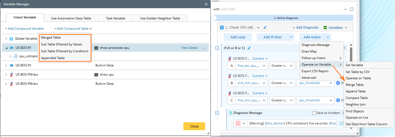

  • Table Operations: Users can define compound table to merge two table variables in the same NI into one table variable, and they can also define table-related diagnosis for table operations.

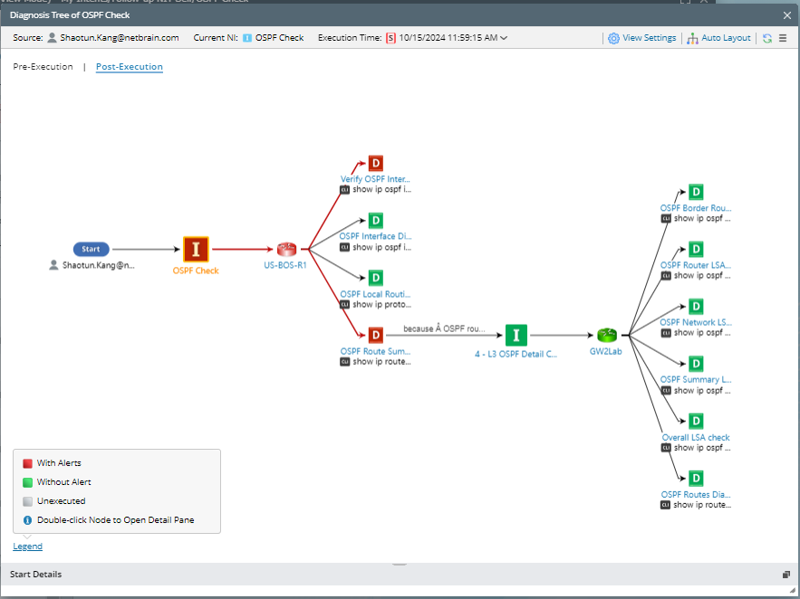

  • Follow-up Network Intent: Users can define follow-up NIs in the diagnosis so that these NIs can be executed under certain conditions. For example, users can add OSPF detail check as the follow-up NI if the OSPF route summary changes.

  • Built-in Functions: These functions help users convert predefined variables into the required formats.
After intent execution, users can view the intent status code, or view the execution results in a diagnosis tree or on a map.
