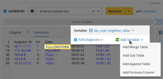

Quickly Add Diagnosis with Template
You can add diagnoses with the template by selecting a variable in the command result.

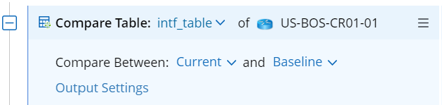

For example, you can select a table variable, and then select Compare with Baseline, a diagnosis is automatically defined based on the predefined rules.
Information Note: You can also add variables here.
When you select a single-value variable, the dialog will also pop up.
The related information of the diagnosis template is summarized as follows:
Variable TypeSupported TemplateDefault Diagnosis
Table
Compare with Last
Compare Table
Table Column
Compare with Last
Compare with Customized Value
