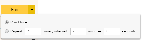

  1. Click Run.
    InformationNote: You can set the frequency to recur the execution repeatedly. By default, the Run Once is selected.

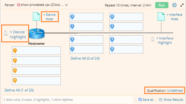

  4. (Optional) Define a CLI automation and monitor network devices on the map.
  • Select a Parser from the list.
    Information Tip: The system will use device types of all target devices and specified CLI commands to search for available parsers from the Parser Library. and populate them in the list. If only one parser in the Parser Library is matched, the parser will be auto-selected.
    Tip: With the alert defined for the variable in the CLI command result, it is displayed if the variable deviates from the defined value.
    Information Note: You can also click Save As to save the defined CLI automation as a Qapp or a Data View Template, or add it as a Qapp or Data View Template node to the current Runbook.
  • Click a number value and Map to Device to expand the definition area.
    Table
  • Define the automation.
    A picture containing graphical user interface
1) Click Device Highlight to use a random color to highlight the device.
2) Click the icon behind the device variable to define the alert. Click OK.
Note: You can define the qualification to make the CLI automation take effect for more accurate target devices. By default, it is undefined, and the automation takes effect for all map devices.
3) Click Run to monitor the variables on the map.
