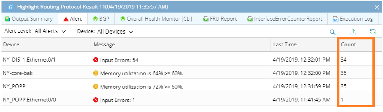

  • Alert
    The Alert Output tab shows the events, especially alerts, triggered at both the device and interface levels during a Qapp/Gapp execution. Duplicate alerts are merged into one entry, and the number in the Count column increases by 1.
    Event messages are categorized into four levels: Error, Warning, Information, and System. To filter messages by event level, you can click the icon to select target levels.
    Information Note: Displayed event levels might differ depending on the selected Run Mode of Qapps/Gapps. Only events in Error and Warning levels are duplicated in the Managing Events.

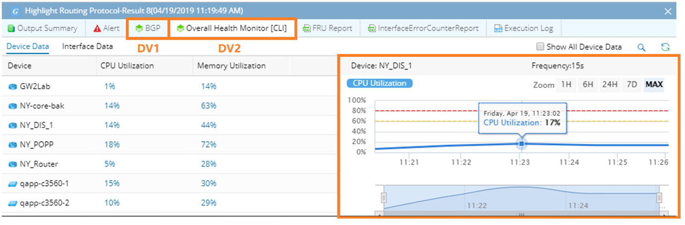

  • Data View
    The Data View Output tab shows the metrics of devices and interfaces generated when users run a Qapp/Gapp. For numerical metrics, users can view the historical data and trends of a specific metric over a period in a chart.

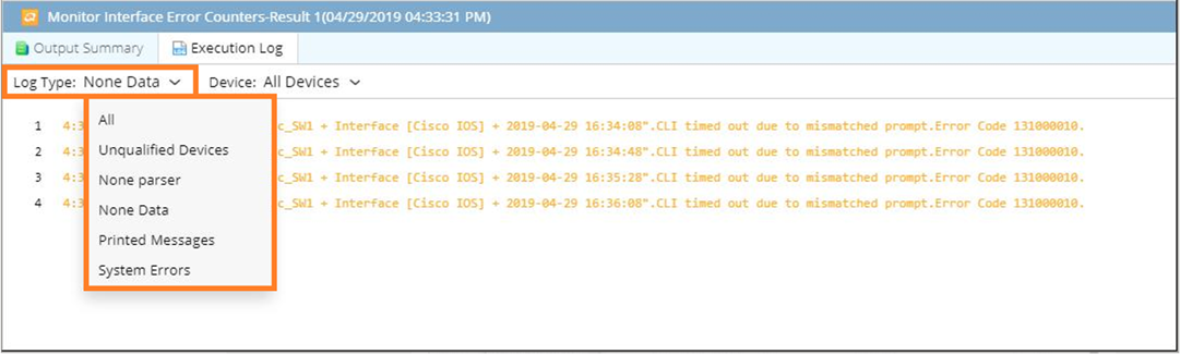

  • Execution Log
    The Execution Log tab shows the detailed execution logs with error codes for root cause analysis when you run a Qapp/Gapp. It provides filters to narrow down logs based on log types and devices.
