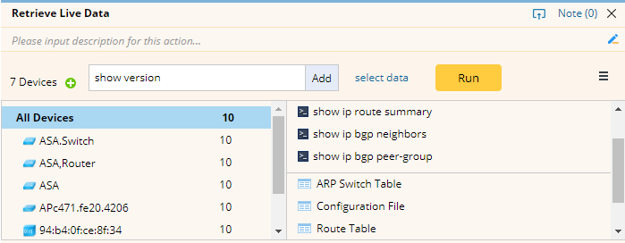

  3. Enter the CLI command and click Add repeatedly to add multiple CLI commands. By default, all the commands in the list will be executed for all target devices. To add a CLI command for a specific device, select the device in the device list, enter the command, and click Add.
    Information Tip: To add commands using CLI templates, click the  icon and select Load CLI Templates. You can also create your own template. See CLI Template for more details.

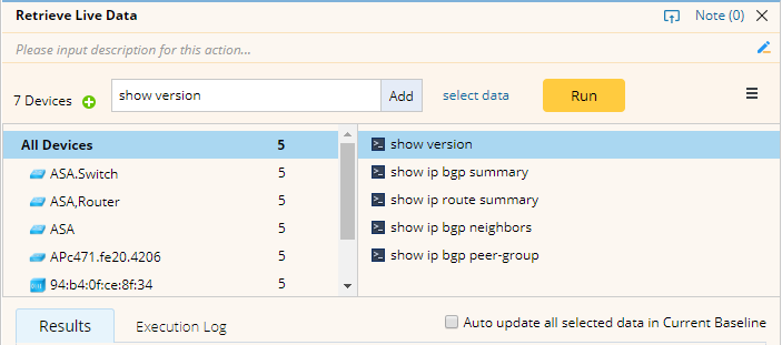

    Information Tip: To save the retrieved data as the latest copy for future analysis and comparison, select the Auto update all selected data in Current Baseline check box.
  2. Review the selected commands and click Run.
  1. After the execution is finished, select a specific CLI command to view its output, or click the Execution Log tab to view the execution log.
