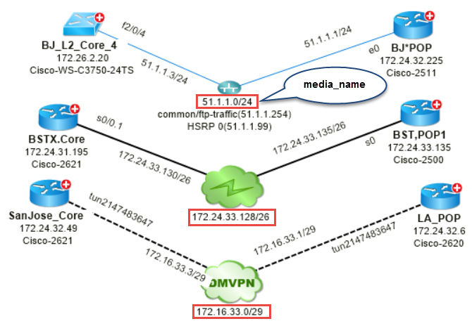

GetDevicesByMedia(media_name, media_type, topology_type)
Return the devices connected to a specific media. The returned data type is list.
media_name — the LAN or WAN segment that interfaces connect to in common.
media_type — the media type of interfaces, such as 100BaseTX.

GetInterfacesByMedia(media_name, media_type, topology_type)
media_name — the LAN or WAN segment that devices connect to in common.

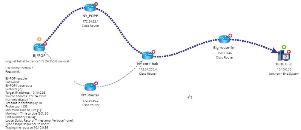

DrawTraceRouteHops([{'ips':[]}])
Draw the traceroute result hop by hop on a map based on the IP address of each hop. The parameter of this API is a sequential hop list and you need to enter all hops based on the sequence that a hop is drawn.
ips — The IP address of a hop. Input all load balance IP addresses in the ips field if a hop contains load balance. For example, 'ips':["IP2","IP3"], IP2 and IP3 are loading-balancing hop.

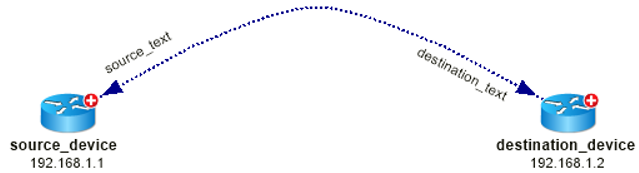

HighlightNeighbor(source_device_name, destination_device_name, legend, source_text, destination_text[, color, two_way, line_style, thickness, map_name, page_name])
Highlight the specified neighbor of a device on a map.
source_device_name — the hostname of the source device.
destination_device_name — the hostname of the neighbor device.
legend — the legend name.
source_text — any strings about the source device.
destination_text — any strings about the neighbor device.
color — the color of the highlighted interface. The default value is color. random. See color for more details.
two_way — whether to draw a line with two directions. The value type is bool and the default value is false.
line_style — the style of the line. See line style for more details.
thickness — the thickness of the link. The default value is 2.
map_name — the name of a map. The default value is null, which means that the map that the current Qapp runs on.
page_name — the name of the map page. The default value is null, which means that the map page that the current Qapp runs on.
