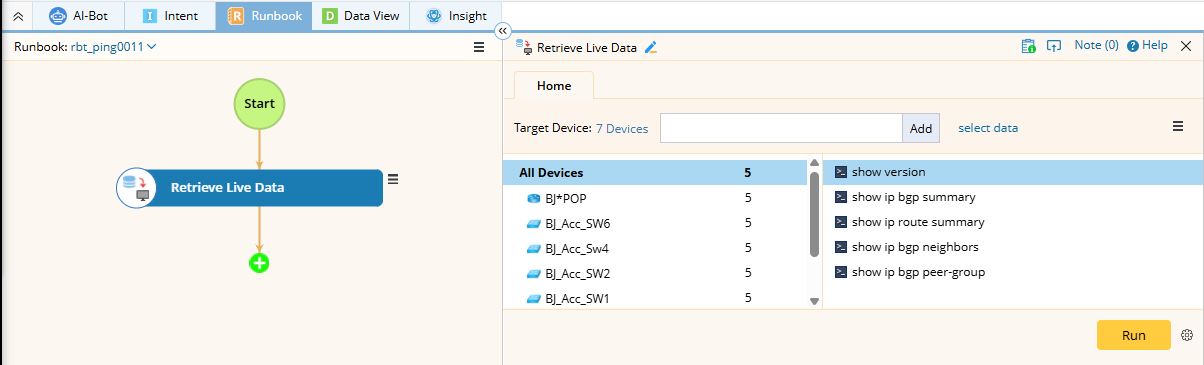

  1. Add Retrieve Live Data Action: On a map, select Retrieve Live Data from the right-click menu. The Runbook pane opens with the Retrieve Live Data action node added.

  3. Add CLI Commands: Enter a CLI command in the input field and click Add. Repeat the same to add multiple commands.
    • By default, each command will be executed on all target devices.
    • To add a  command to a specific device: Select the device first, and then enter the command > click Add.

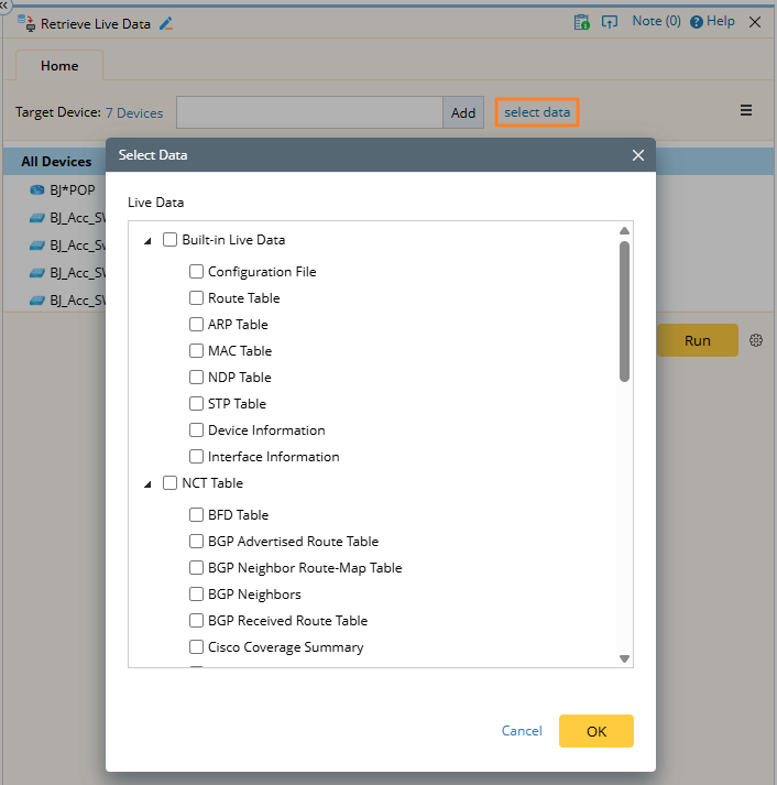

  4. Select Data Type(s): Click Select data to add more data types (e.g., interface status, route tables).

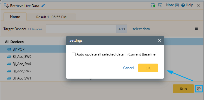

    Tip: To save the retrieved data as the latest copy for future comparison, click the settings icon and enable the Auto update all selected data in Current Baseline.
