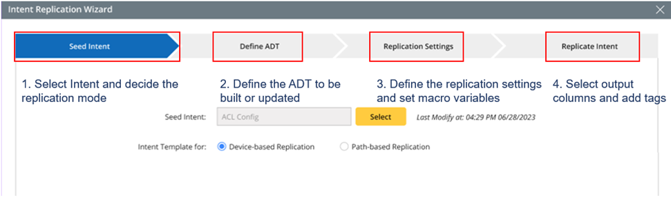

Each step of the Intent Replication Wizard aims to:

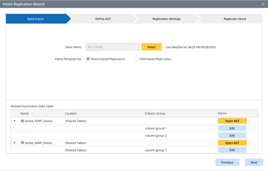

  • Seed Intent: Select the seed intent for intent replication and choose the applicable replication mode.

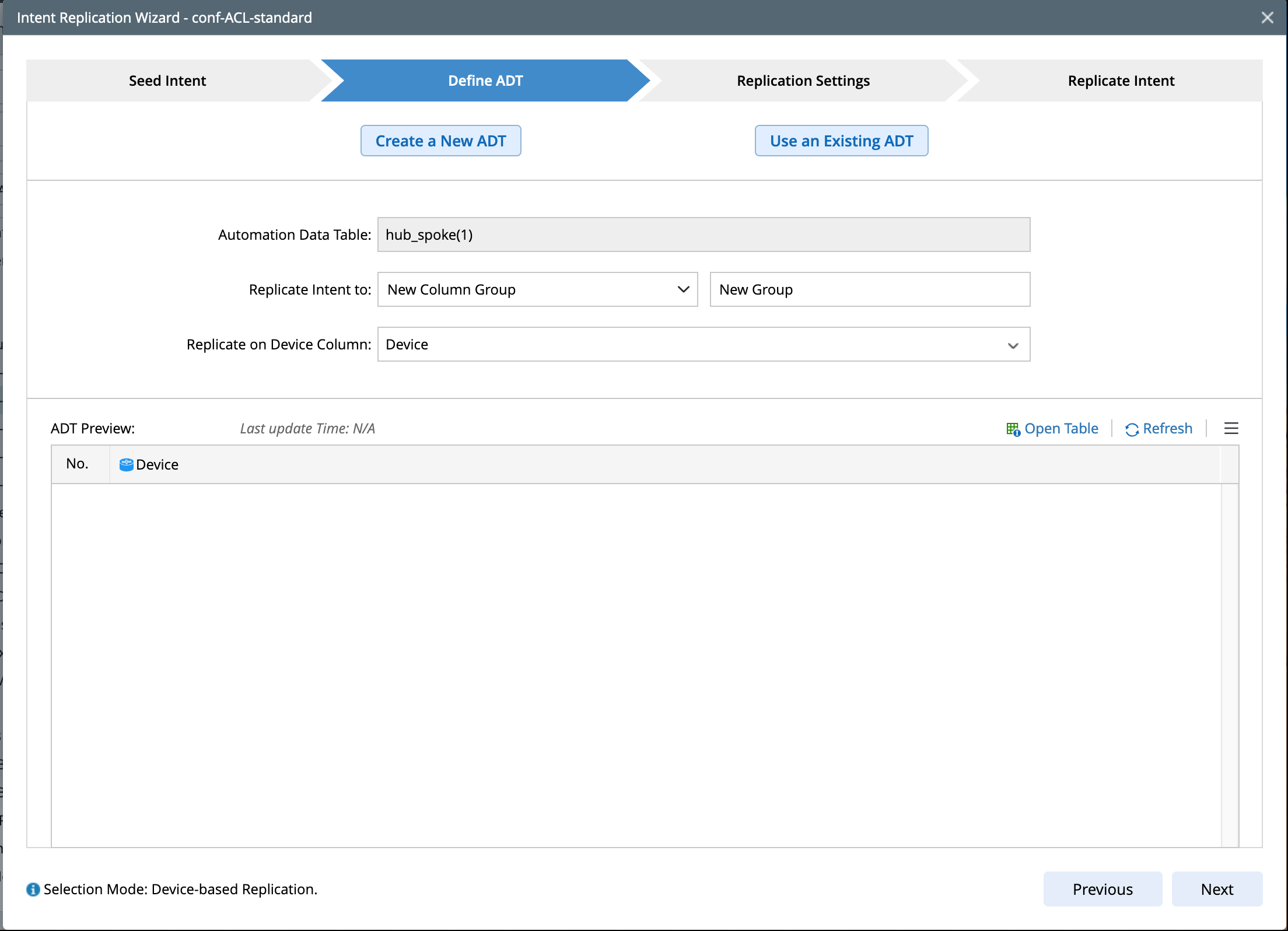

  • Define ADT: Create a new ADT or select an existing ADT and then utilize it to accomplish the replication of the seed intent.

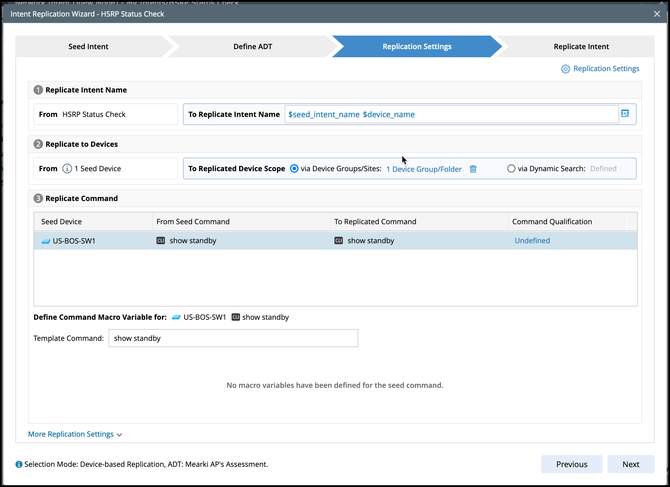

  • Replication Settings: Define the qualified device scope for the seed intent template to replicate intent and configure the macro variable values for replicating ADT intents. Also, other advanced replication settings can be made here.
  • Replicate Intent: Select data fields that will be outputted as columns in the column group, then define the display name or assign tags for each column to finish building or updating the ADT.

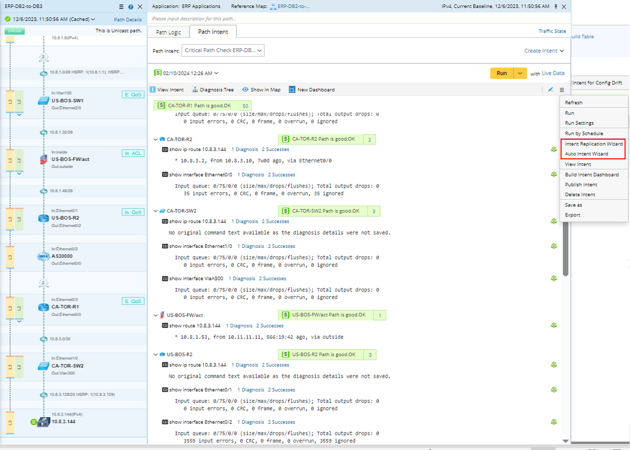

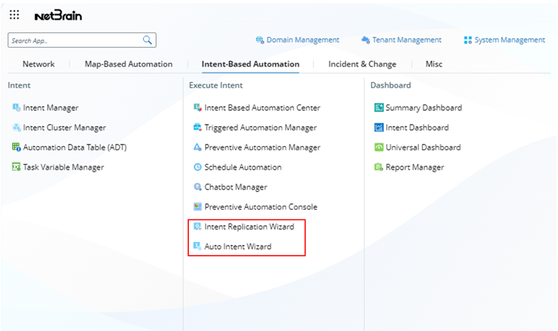

Where to Start

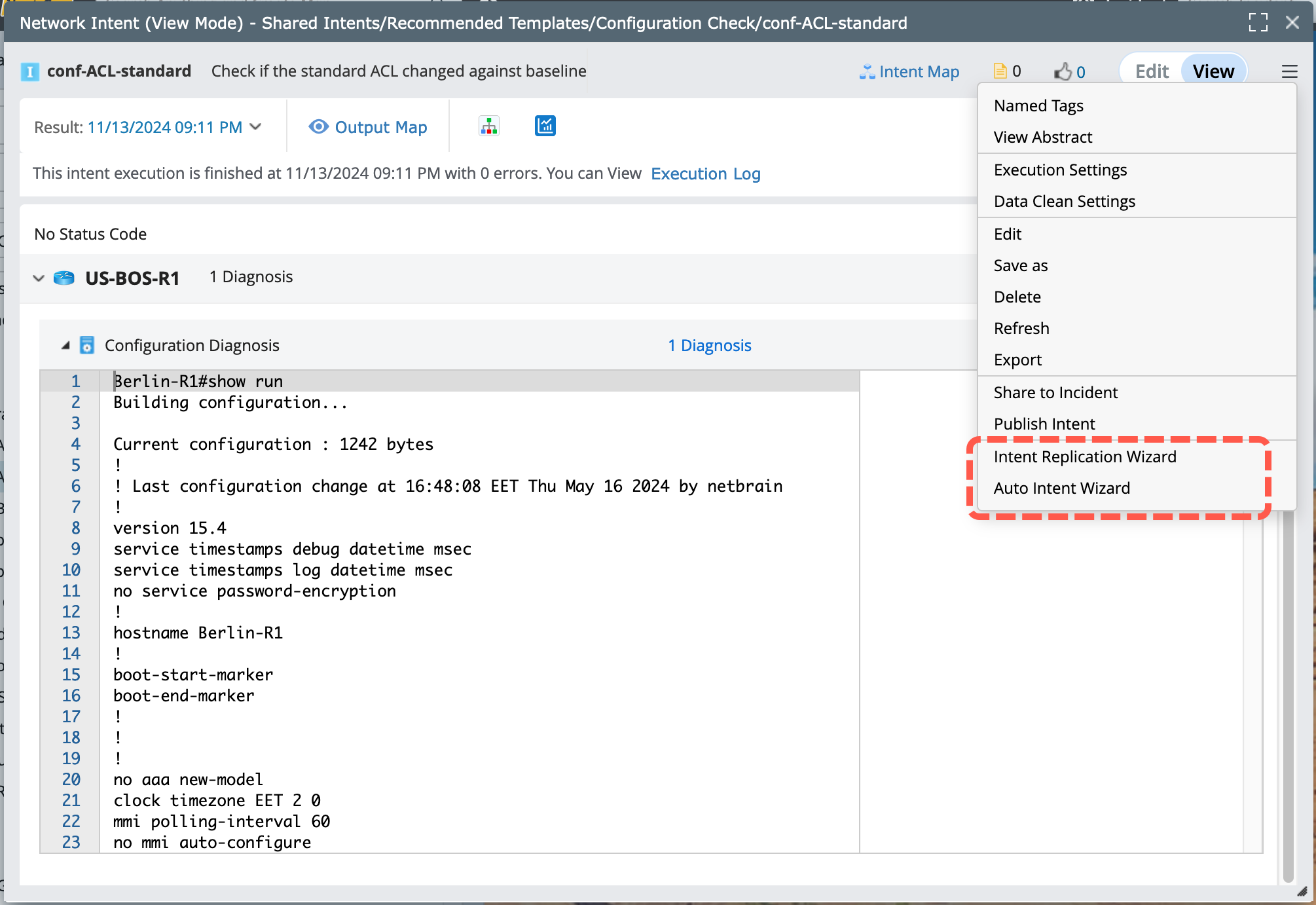

The following table lists the entry points for launching the Intent Replication Wizard and the Auto Intent Wizard.
Table 1 - Intent Replication Wizard Entrance
No.
Feature
Description
1
Start Menu
2
 Intent (view Mode)

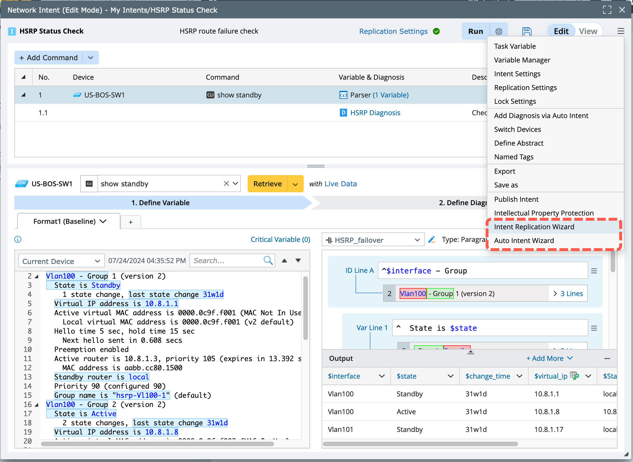

3
Intent (Edit Mode)
4
NI Manager
5

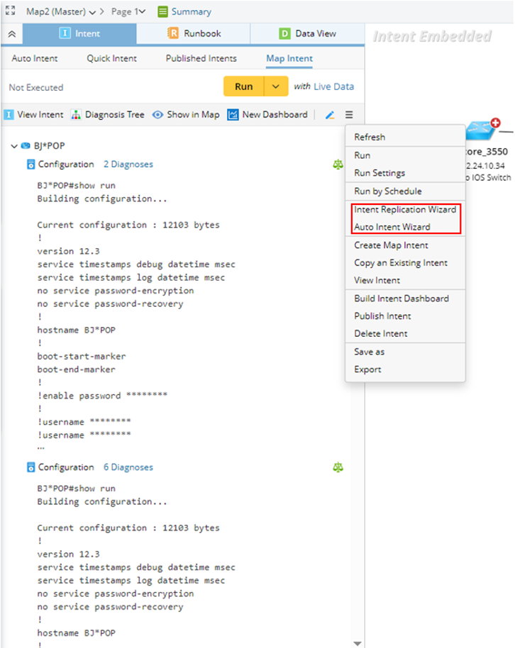

Map (Map Intent tab)

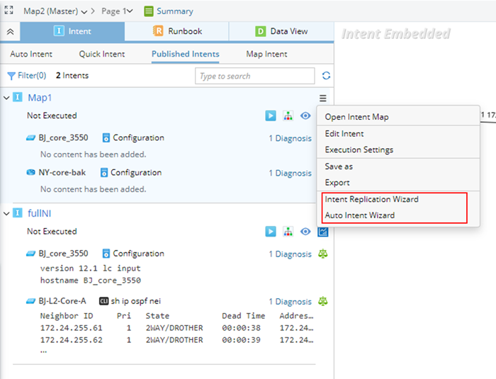

6
Map (Published Intents tab)
7
Path Browser (Path Intent tab)

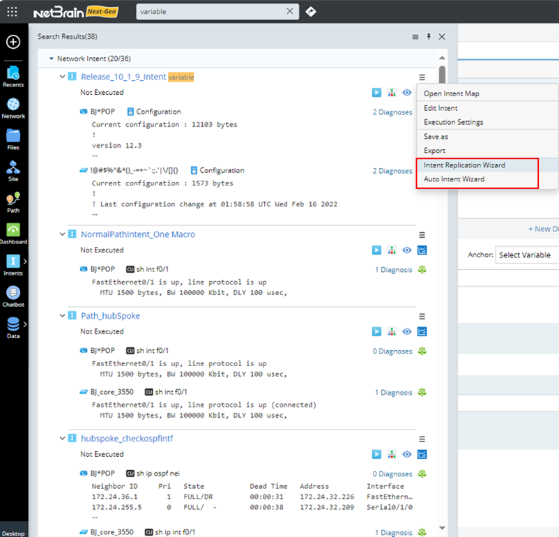

8
Search Results
