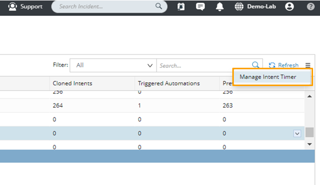

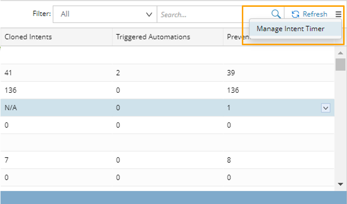

You can click the icon at the upper right of the Installed Intent Templates pane, then select Manage Intent Timer to manage timers.

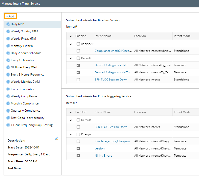

In the Manage Intent Timer Service window, you can view intent timers, add new intent timers and view how intent timers are applied to the intents in the Intent-based Automation Center.
  • All the existing intent timers are organized in the left pane. You can click an intent timer item in the list to view its details.
  • The lower area of the left pane presents the basic information of the selected intent timer item.
  • The Subscribed Intents for Baseline Service  area to the right displays how many NITs use the current timer for baseline service.

  2. In the top left of the Manage Intent Timer Service window, click + Add.

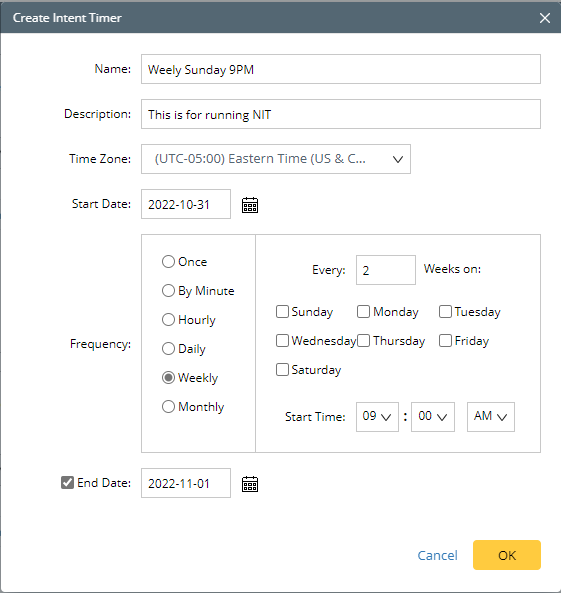

  3. In the Create Intent Timer dialog box, define the new intent timer.
    1. Define basic information: Define information about the intent timer, such as Name, Description, and Time Zone.
    2. Define Start Date: Select a date when the intent timer is put into service.
    3. Define the Frequency: Define the frequency at which the intent timer starts operations (available frequency ranges include Once, By Minute, Hourly, Daily, Weekly, and Monthly).
    4. Define the End Date: Select when the intent timer expires.
  4. Click OK to save the settings. The defined intent timer is displayed at the bottom left of the Manage Intent Timer Service window.

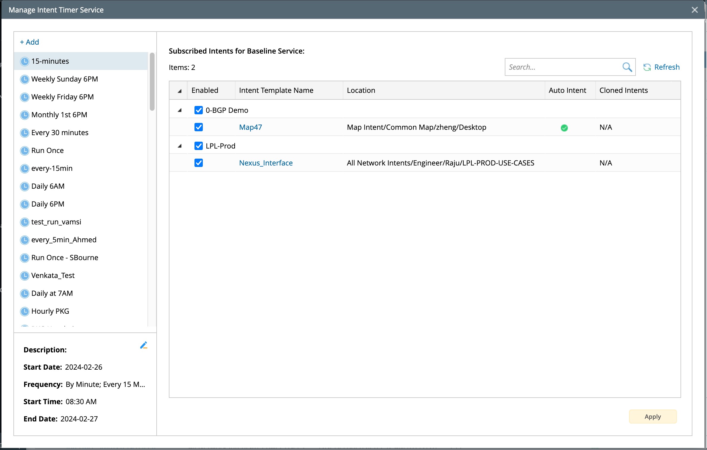

In the Manage Intent Timer Service window, you can disable the services provided by an intent timer to an intent. Then the intent timer no longer applies to this intent.
  • Disable baseline decoding for an intent: Uncheck an intent item in the Subscribed Intents for Baseline Service area.

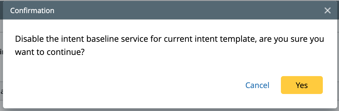

A message will pop up to ask you to confirm the action.
