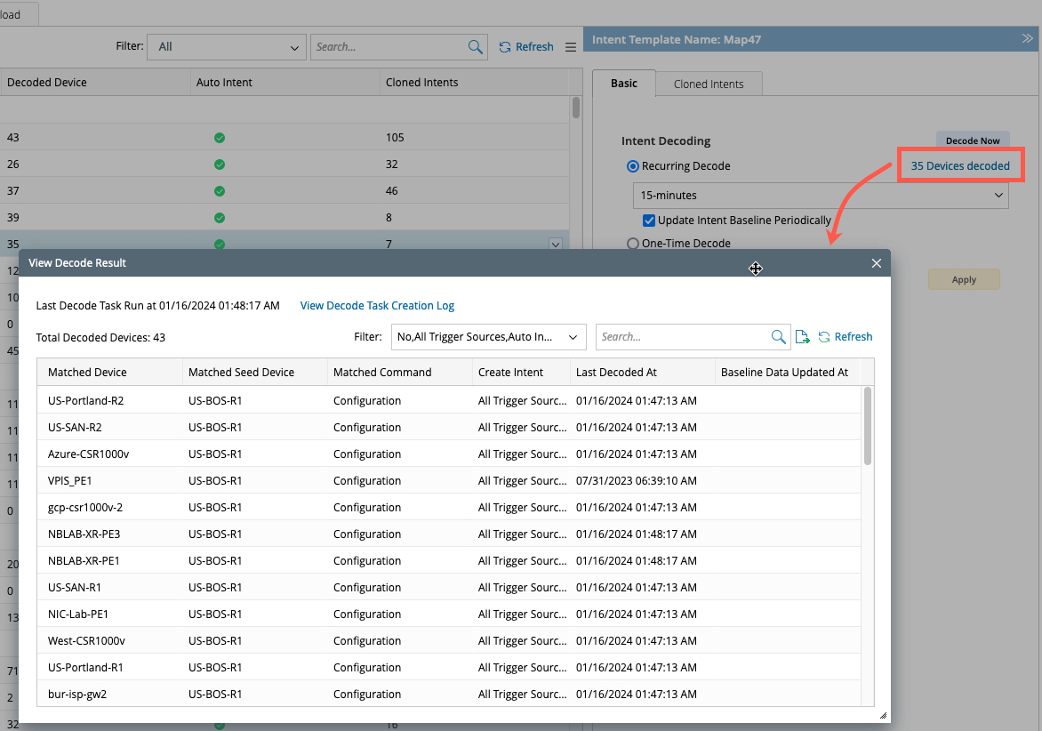

The decoding results are presented in a tabular layout in the window View Decode Result. To view the data, click on X Devices Decoded link to pop-up the window View Decode Result.
Information Note: The number in the hyperlink represents the total number of matched qualified devices.

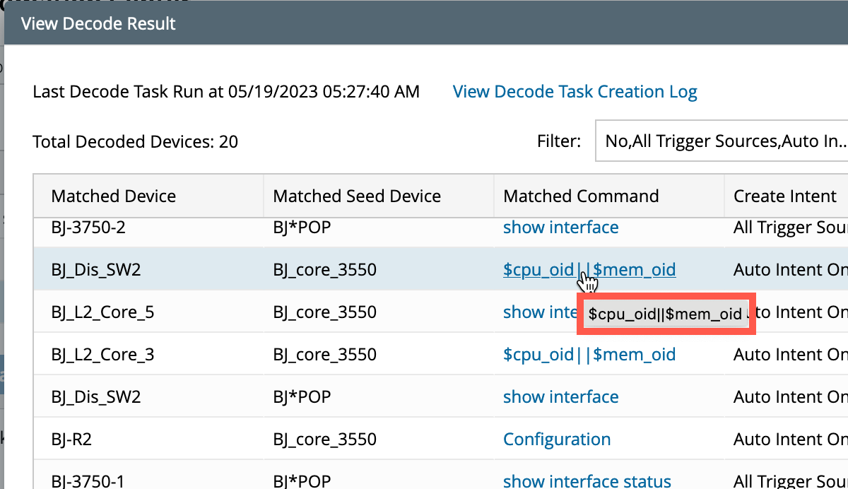

  • Matched Command: The commands that are decoded. And if you hover the cursor, the parameters of the API parser will be displayed.

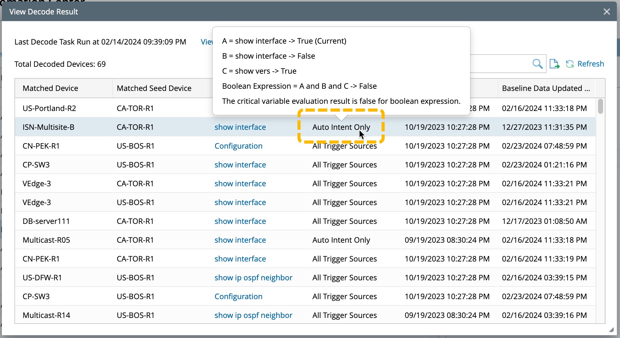

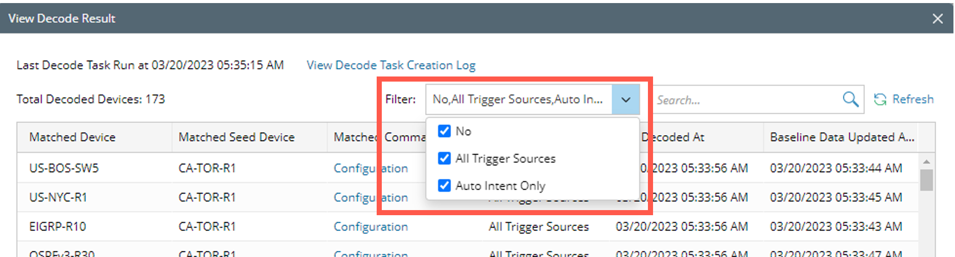

  • Create Intent: It provides the information on whether a NI is created and under which criteria.  An option is provided to filter the Create Intent column and view the results as needed:
The information under this column would be:
  • No: If a command test is successful, but failed critical variable test. Hover the mouse on the command to display the specific reason.
  • All Trigger sources.
  • Auto Intent Only: Hover the mouse on the command to display the specific reason.

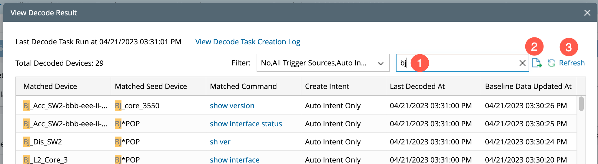

  1. Search: The system supports searching the results with keywords (search keywords are the information in the columns Matched Devices, Matched Seed Device, and Matched Command).
  2. Export: To export the results, click Export at the top right of the window next to Search.
  3. Refresh: Click Refresh to refresh the table and get latest decoding results.

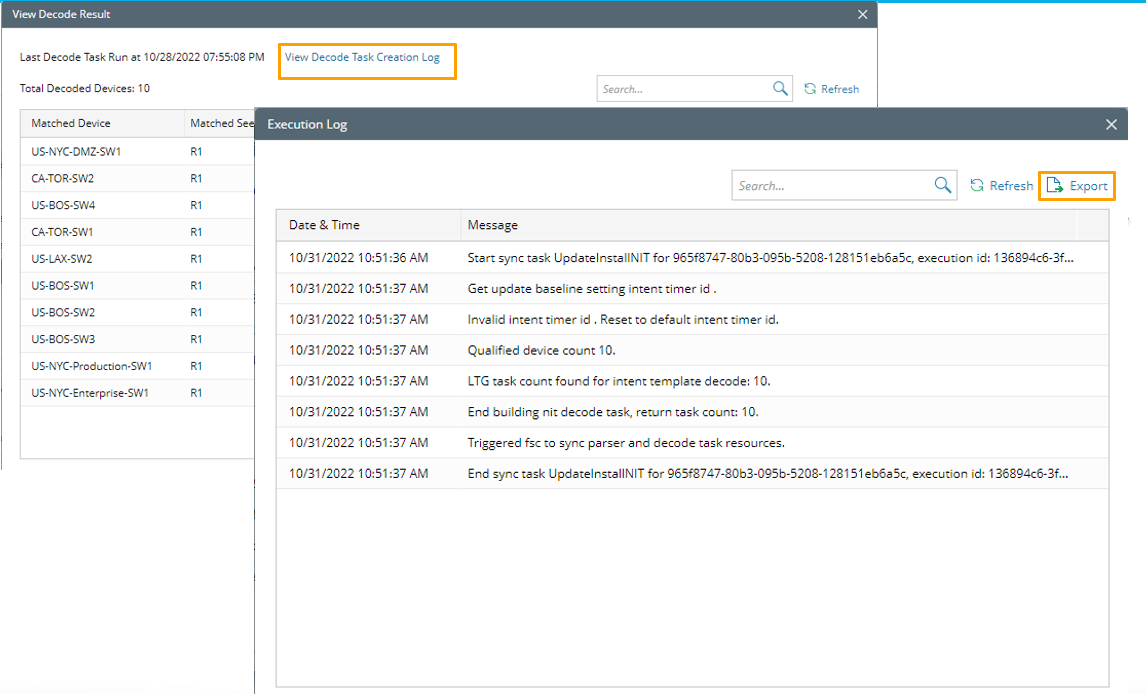

  4. You can click View Decode Task Creation Log to view the execution log for the last device decoding.
    Note:  The content displayed in the View Decode Task Creation Log depends on the   Decode Settings .
    •    If Live Data is selected, it displays the log for generating Decode Task.
    •    If Current Baseline or ADT Dataset is chosen, it displays the log for device decoding.
