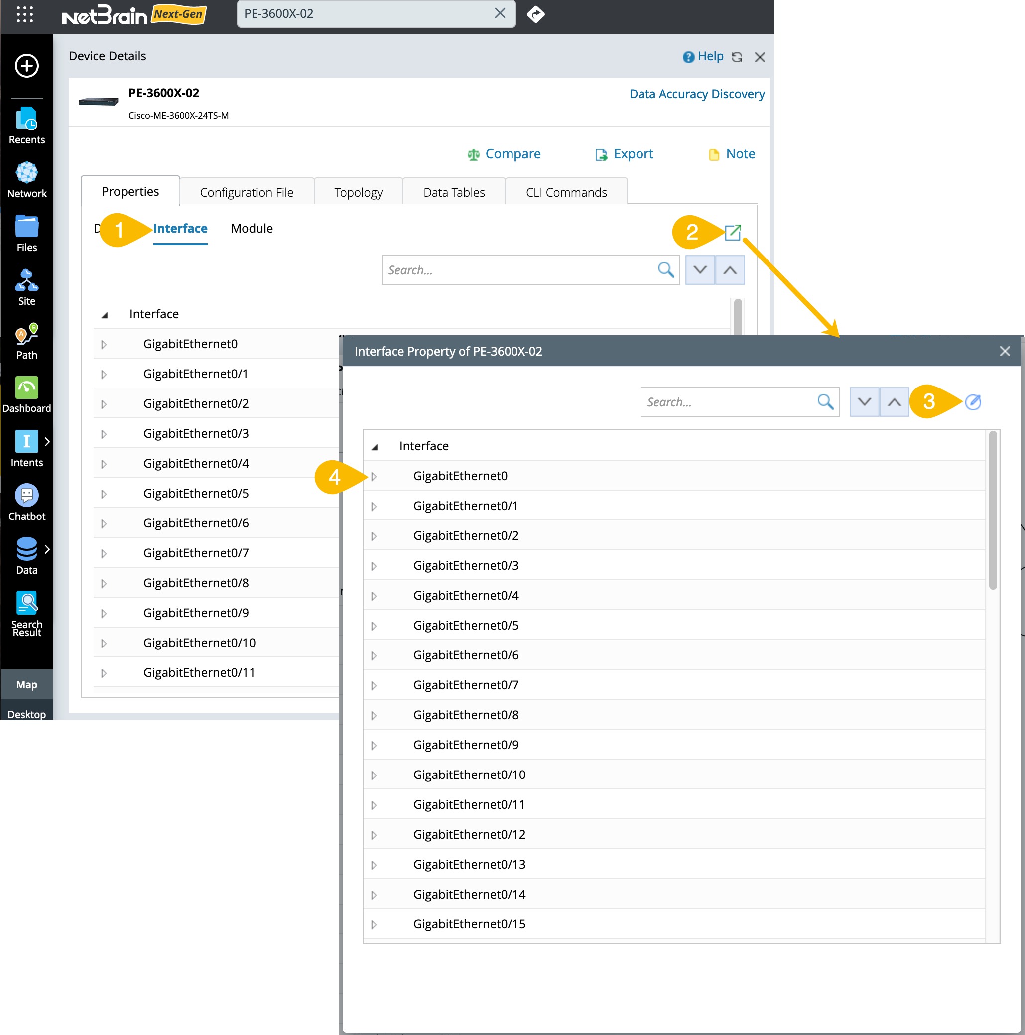

Modifying Interface Property Value in Device Details Pane
- In the Device Details pane, select the Properties > Interface tab. The interface properties are listed by interface type.
- Click the
icon to pop out the interface details in a pop-up dialog.
Click the
icon to enter the editing mode.
- To expand the interfaces you want to modify, open the interface by clicking
Modify the values of the interface properties and click Save.
Note: The values of some built-in interface properties cannot be edited. |
