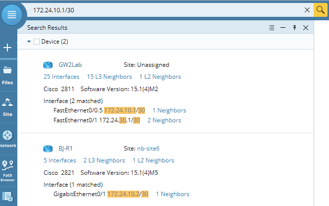

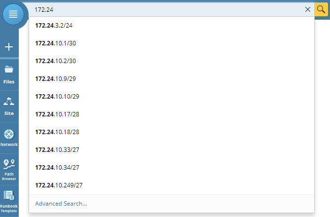

1.Enter an IP address in the search bar.
2.Press the Enter key or click the
icon to start searching. The search results are displayed with the matched keyword highlighted.
Tip: When searching for devices by using text string in the configuration file, you can select the Configuration tab to narrow down the search results to those which match the keyword combination exactly in their configuration files.

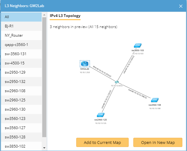

3.Click the X L3 Neighbors hyperlink (for instance, 15 L3 Neighbors). A preview map containing the searched device (for instance, GW2Lab) and its neighbors is displayed.
4.To display the preview map on the existing map, click Add to Current Map; To display the preview map on a new map, click Open in New Map.

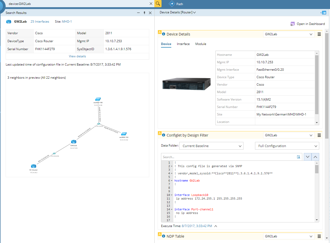

Click the device name in the search result. A Device Details dashboard matching its device type opens, showing the detailed information about the device. See Semantic Search for further operations. |
