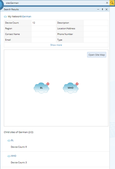

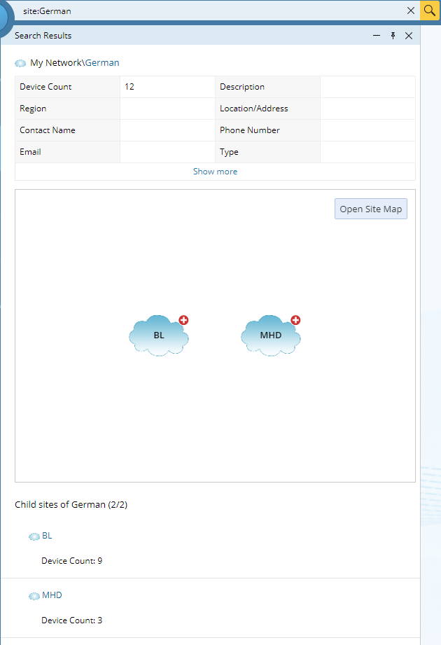

Searching with site:$site_name
1.Enter a specific site name in the search field. For example, site:German.
2.Click the icon or press the Enter key on your keyboard to start searching. The corresponding site map is shown and all child sites or devices under the site are listed.
3.To open the site map, point to the preview map, and then click Open Site Map.

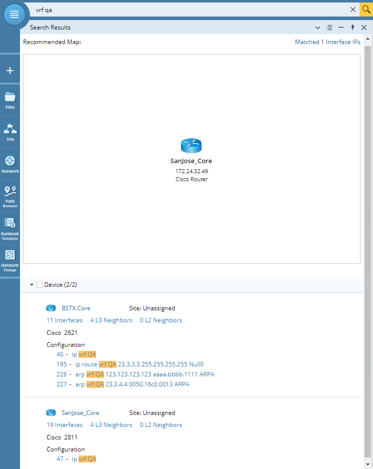

Searching with vrf $vrf_name
1.Enter a specific VRF name in the search field. For example, vrf QA.
2.Click the icon or press the Enter key on your keyboard to start searching. Devices and interfaces matching with the VRF are diagrammed and auto-linked on a preview map, including their neighbors.
Note: The recommended map in search results shows at most 20 devices and 10 links for each device (including those links connected through a media).
3.Click Open Map to view all the devices and links.

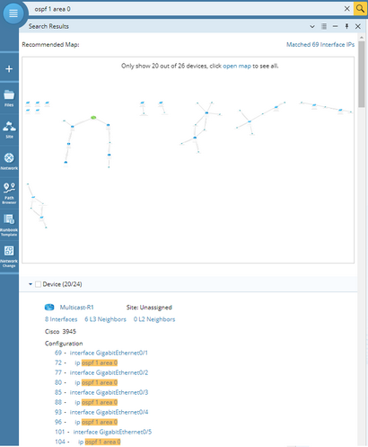

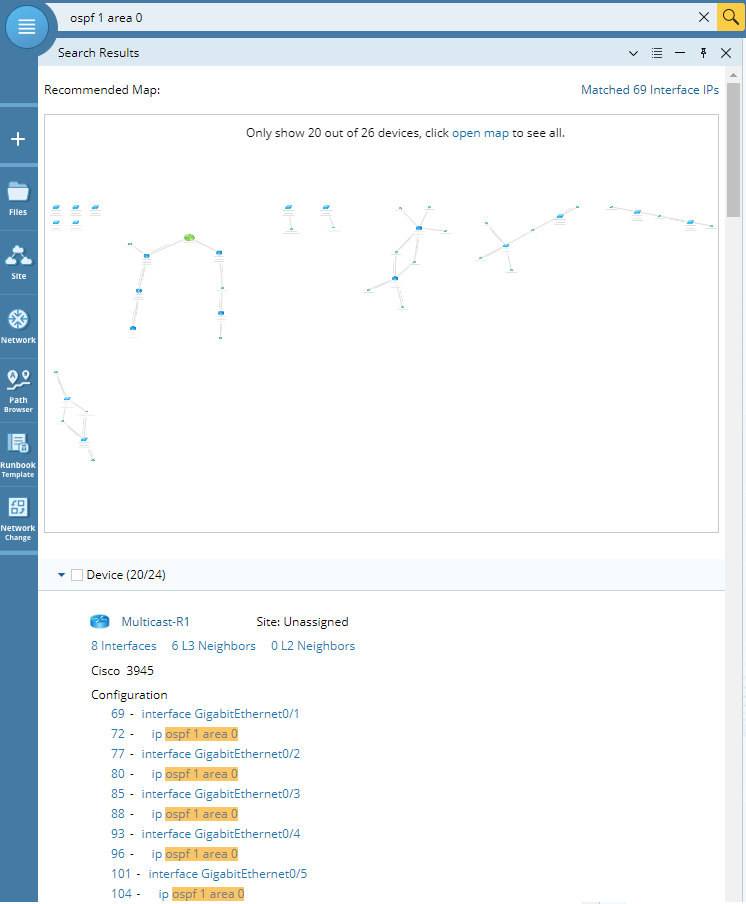

Searching with ospf (process-id) area $area_ID
1.Enter a specific OSPF process and area ID in the search field. For example: ospf 1 area 0.
Note: For IPv6 OSPF, use the ospfv3 (process-id) area $area_ID term.
2.Click the icon or press the Enter key on your keyboard to start searching. Devices and interfaces matching with the OSPF are diagrammed and auto-linked in a preview map.
