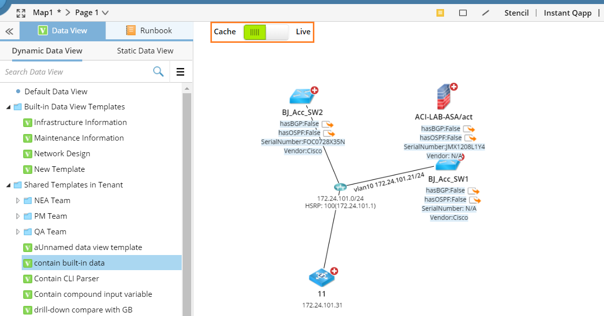

Dynamic Data View
Dynamic Data View refers to those data views generated by applying Data View Templates (DVT) to a map page. See Applying a Dynamic Data View to View Alert and Drill Down for more details.

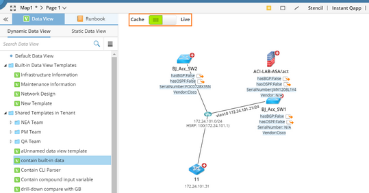

Tip: The indicates the data view template has been scheduled to run; the icon indicates the data view template hasn't been scheduled to run.
Tip: To pull live data in a data view, you can toggle the switch from Cache to Live.

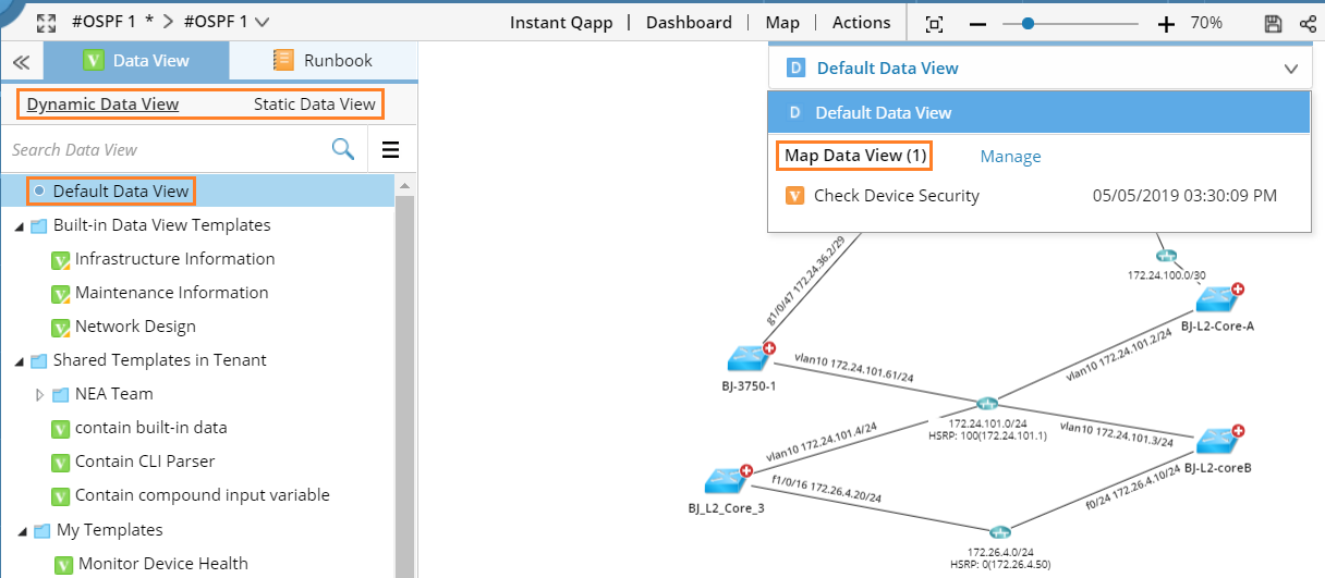

Map Data View
Map Data View refers to a data view that is saved within a map, and can only be visible in the map. It is generated by saving a dynamic/static data view.
To view Map Data Vies, select the Map Data View pane and then click the icon on the top of the map.
Tip: You can click the icon to edit the map data view after the data view is applied.

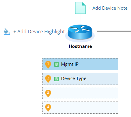

Default Data Units on Traditional Device Positions
Position
Device Data Unit
Position1
Management IP
Position2
Device Type
Position3
NULL
Position4
NULL
See the picture below to understand the device position.
Note: If the value of a data unit is null, it will not be displayed in the specified position.
