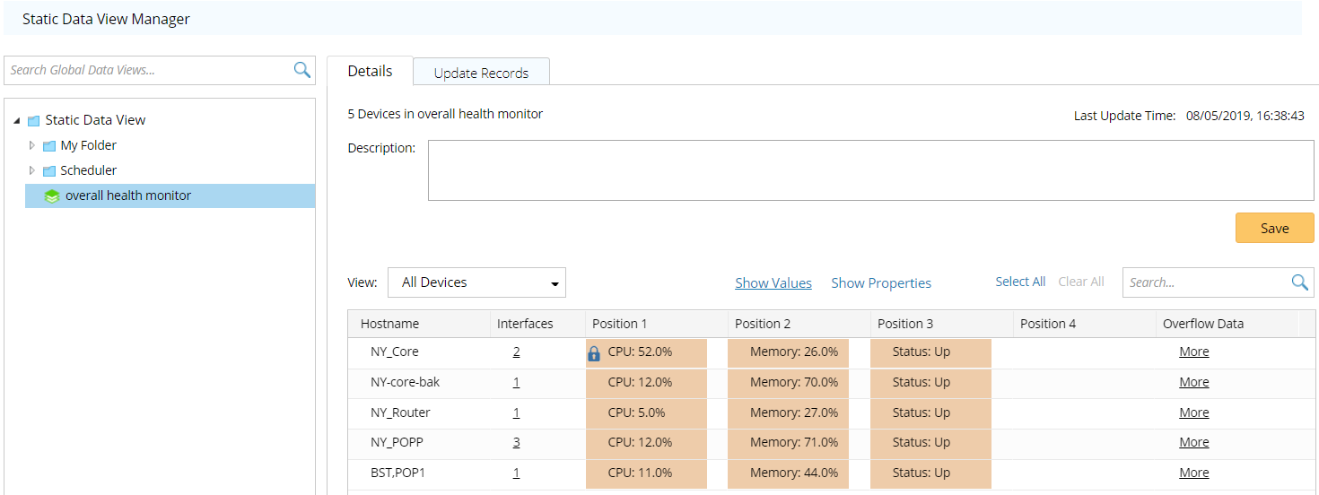

1.Click the start menu and select Static Data View Manager. The Data View Manager opens on a new tab page, listing all static data views.
2.Click a data view in the left pane. All included devices are listed under the Details tab. The value of each data unit is displayed in its position.
3.Click Show Properties to only show the data unit names.

View
Select Only Devices with Overwrites to view the data views that were manually saved.
Select Only Devices with Defaults to view the data views directly generated through benchmark tasks or scheduled Qapp/Gapp execution.
The manually edited device data units and interface data units are highlighted with a background color.
Indicates the data unit is locked. The manually edited data units are locked automatically.
A locked data unit will no longer be updated even if the data view is updated. See locking a data unit for more details.
More
Click More to view the overflowed data units.
Interfaces
The number in the Interface column indicates the count of interfaces contained in the data view.
Click the hyperlink to view the detailed interface data units.
