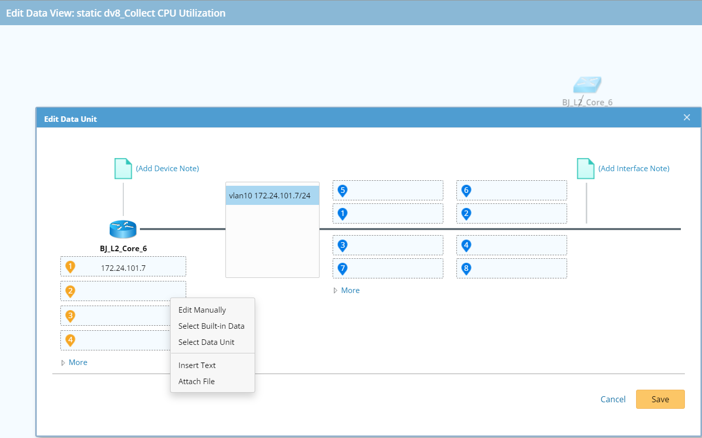

3.In the editing mode, click the device BJ_L2_Core_6. The existing device data units are displayed in the corresponding positions.
1)Point to a blank device position and click the icon to select Select Built-in Data from the drop-down menu.
Tip: If all the reserved positions are occupied, you can add data units on overflowed positions.
Tip: For more details about the drop-down menu, refer to the following table .

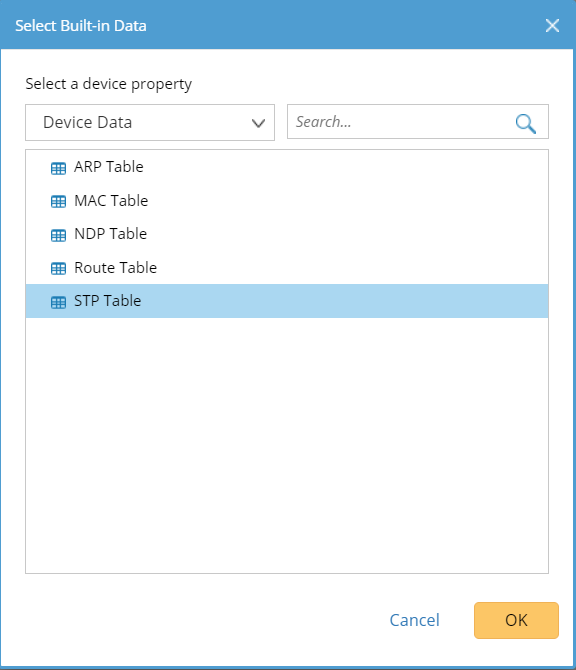

2)Select Device Data from the drop-down list and select STP Table from the available table types. Click OK.
