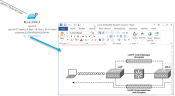

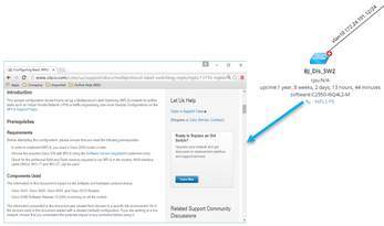

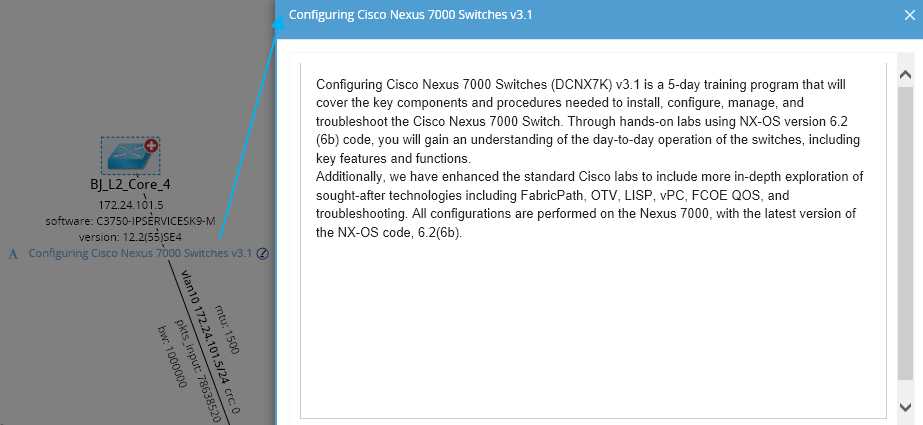

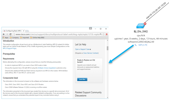

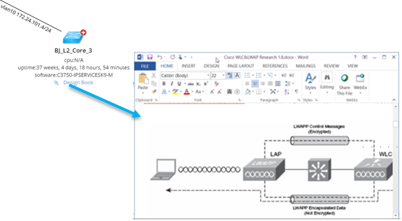

You can manually add, edit, and remove data units in data views. Many types of data units can be added to data views, such as hyperlinks, rich texts, and attachments. If all the reserved positions are occupied, you can add data units on overflowed positions.

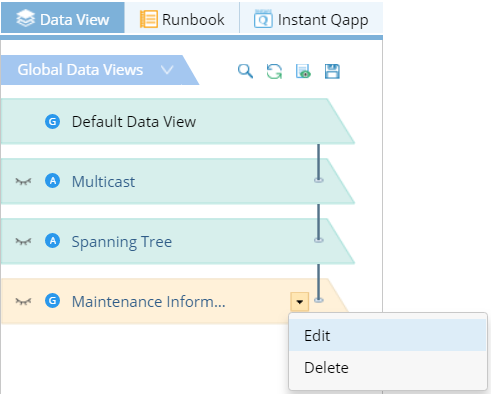

1.In the Data View pane, point to Maintenance Information and click the
icon to select Edit.

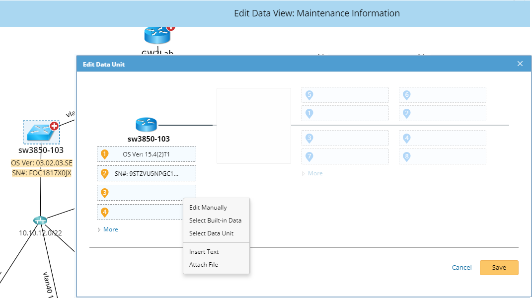

2.In the editing mode, click the target device icon. The existing device data units are displayed in the corresponding positions. To add a device data unit:
1)Point to an empty device position and click the
icon to select Select Built-in Data from the drop-down menu.

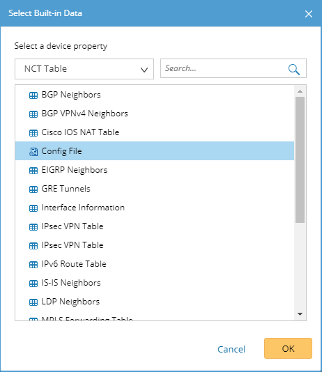

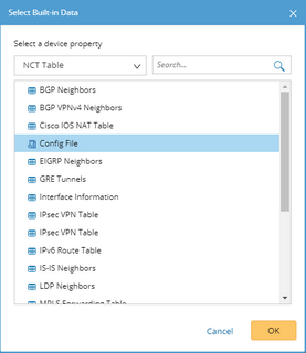

2)Select NCT Table from the drop-down list and select Config File from the available table types. Click OK.
