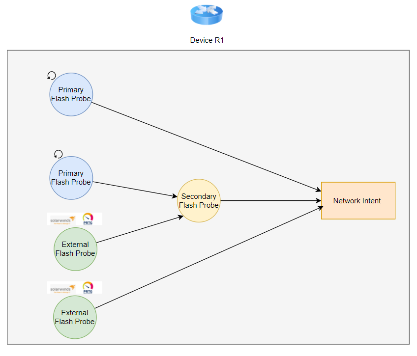

From the Monitoring Probe tab of Preventive Automation Manager, you can define the following three types of flash probes:
Primary Probe: Primary flash probes can be polled frequently at the desired frequency. Two types of primary flash probes are currently supported:
oAlert-based Flash Probe: triggered by device-generated anomaly.
oTimer-based Flash Probe: triggered by timer and can be used for scheduled CLI/scheduled NI tasks.
Secondary Probe: Secondary flash probes will not be polled periodically like primary probes, instead, they can be triggered by:
oPrimary Probe (of the same devices or other devices)
oExternal probe
External Probe: External probes are used for integration with other monitoring system. Once the integration is completed, the alert triggered by 3rd party systems can implicitly generate external flash probes.
