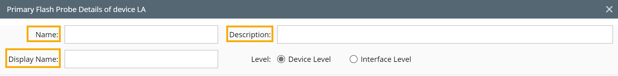

1)Define the basic information, such as the name, display name and description of the flash probe.

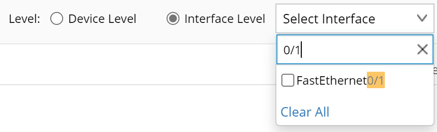

•To capture device-level anomalies, such as CPU high, device config change, BGP neighbor flapping, select Device level.

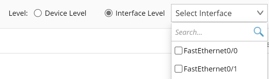

•To capture interface-level anomalies, such as interface flapping, interface error increase, select Interface Level. Flash probe can be configured at multiple interfaces of the same device. In this case, the system will check the selected interfaces one by one. If anomaly exists in any of the selected interfaces, alert will be generated and respective NIs will be triggered.

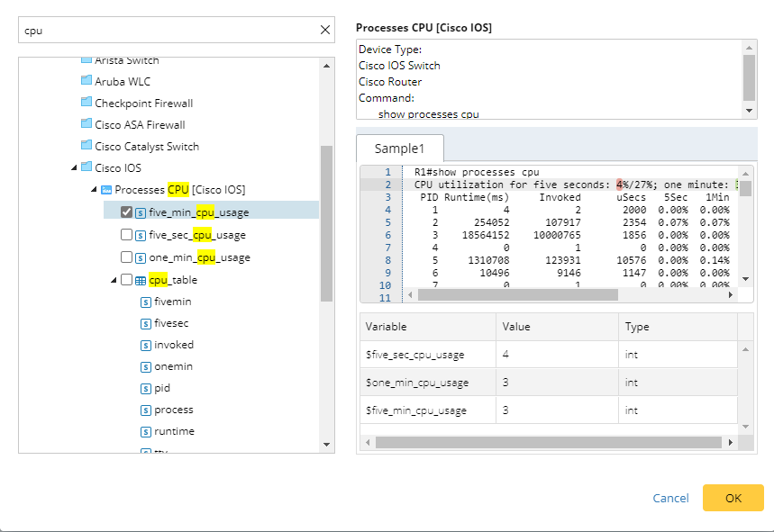

3)To define the variables that need to be monitored, click +Add to add variables.
•When the level is set at device level: Choose Add Device Variable from the drop-down menu. Search and locate the intended variable. Check it then click OK. Once a variable is added, you can also choose Add Compound Variable from the drop-down. menu.
•When the level is set at interface level: Select Add Device Variable or Add Interface Variable from the drop-down.Search and locate the intended variable. Check it then click OK. Once a variable is added, you can also choose Add Compound Variable from the drop-down.

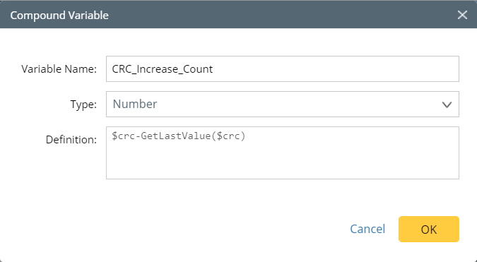

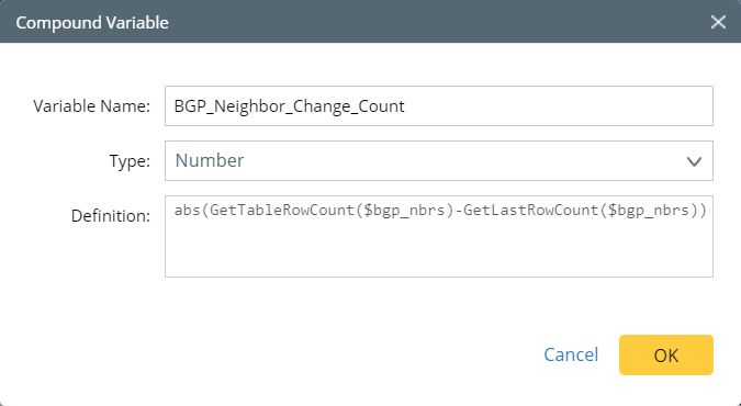

•Compound variables are designed to perform bulk operations on multiple parser variables or use function calls to retrieve certain value. See Compound Variable for more details.
| Example: CRC_Increase_Count = $crc-GetLastValue($crc) In this example, compound variable is used to get the CRC error increase count. ![]() |

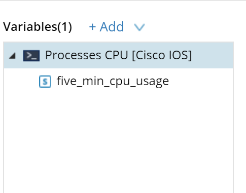

You can select the parser variables deemed to be critical, instead of unselectively storing all historical parser variables. After selecting the specific variables, you can view them in the monitoring data view.

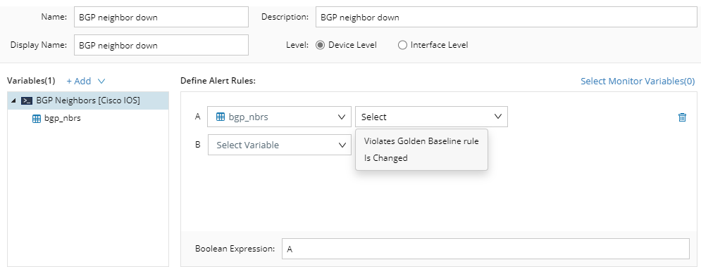

4)Define alert rules.
You can manually define the alert rules or simply leverage the golden baseline to trigger alerts.
•Manually define: Select rules manually to define the statement.
oCompare with last value: You can compare the current variable’s value with a number typed in or its previously retrieved value. To compare with its last value, simply use key word LastValue as the comparison object.
•Golden Baseline: Leverage the golden baseline of the current variable to determine whether the retrieved value violates the golden baseline for this device. If no static rule defined for the current parser variables, NetBrain will dynamically calculate the golden baseline for the current parser variable based on the historical value.
•Is Changed: When comparing the current table with its last value, select Is Changed.

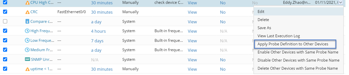

As mentioned above, the flash probe is created on a single device, however, it can be bulk applied to other devices.
The system will check whether the selected devices are valid for bulk application according to the logic below:
•The parser of existing flash probe can also be applied to the target devices. For example, if you use Cisco BGP Neighbor for the existing flash probe definition, you can apply the probe to other Cisco devices; or if the existing flash probe uses SNMP public MIB to get the device interface status, you can apply this flash probe to any other devices since the parser can be applied to all device types.
•If the same flash probe is already configured on other devices, you can decide to overwrite all duplicate flash probes or keep them to suit your specific needs.

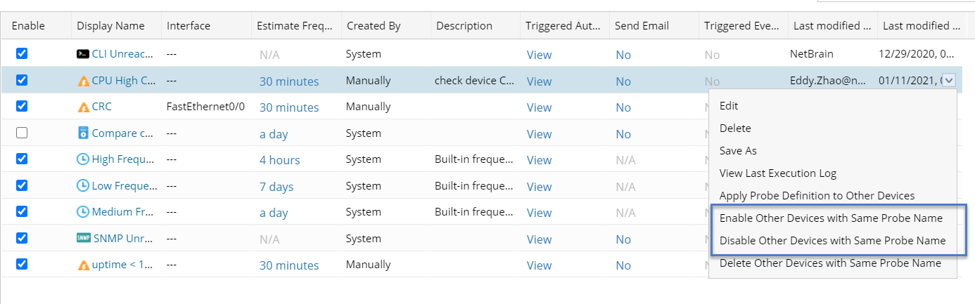

When a flash probe is enabled, it will trigger respective tasks to periodically retrieve data and perform error check. If you want to enable or disable the flash probe for multiple devices, right click a flash probe and choose from the following two options:
•Enable Other Devices with Same Probe Name
•Disable Other Devices with Same Probe Name

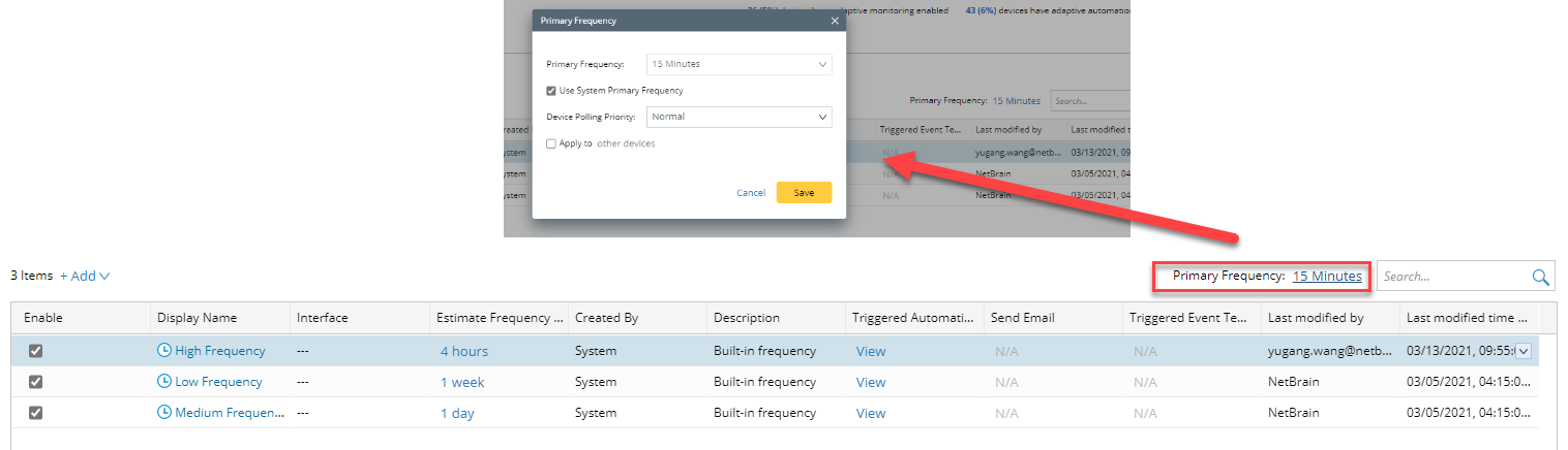

Once enabled, the flash probe will be executed based on the current device’s primary frequency by default. To adjust the flash probe frequency, click the frequency settings of the flash probe (top right corner as highlighted in the screenshot below), and modify the settings accordingly.
