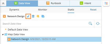

1.On the Static tab of the Data View pane, double-click Network Design to apply it to a map.
2.Click the icon to edit this static data view.

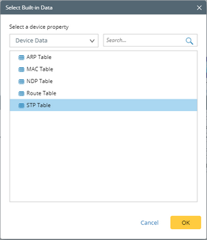

1)Point to a blank device position and click the icon to select Select Built-in Data from the drop-down menu.
Tip: If all the reserved positions are occupied, you can add data units on overflowed positions.
Tip: For more details about the drop-down menu, refer to the following table .

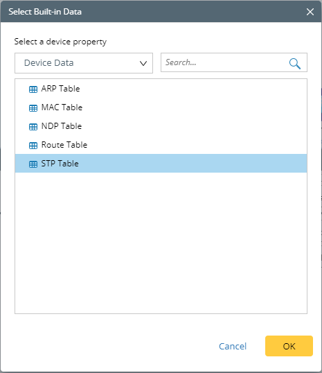

2)Select Device Data from the drop-down list and select STP Table from the available table types. Click OK.
Tip: The manually edited data units will be automatically locked.

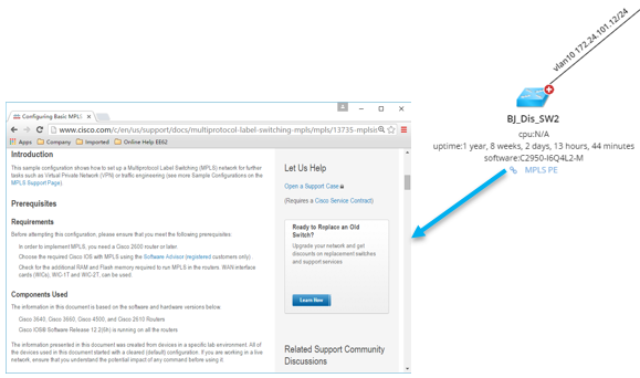

Enter Label / Link
Add a hyperlink as a data unit.
