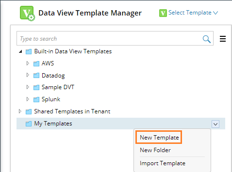

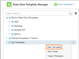

1.Click the start menu
and select Data View Template Manager.
2.In the Data View Template Manager, point to My Templates, and click the
icon to select New Template.

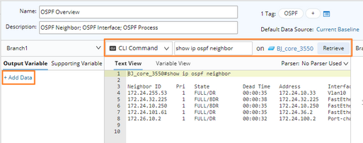

3.Complete the following steps to define the template.
1)Add device basic information.
a.Add a name and a brief description.
b.Add a tag for the template to identify and filter the data view template.
c.Select a data source. By default, the data source is Current Baseline. You can specify what data sources are applicable to a data view template.
2)Add variable for the current Branch 1.
a.Add Output Variable. Click Add Data and select CLI Command, then enter a command for the selected device to retrieve corresponding data.
b.(Optional) You can also add Supporting Variables to this data view template. For example, click Add Built-in Data from the drop-down list of Device Variable to add a built-in variable OSPF Enabling of device property.

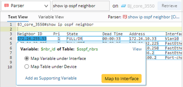

3)Hover over the variable and click Map to Interface/Device to place output variables to interface/device positions.
Tip: You can see the added variable OSPF Enabling in the Supporting Variable. It is highly recommended to add the desired variables to the Supporting Variables to conveniently place them on the device/interface position.

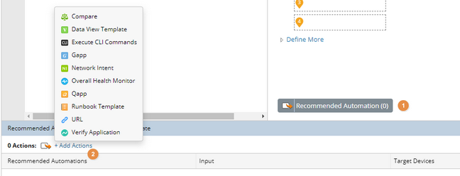

5)Add Recommended Automations at the template level.
a)Click Recommended Actions.
b)Click Add Action and select an action from the action list.
