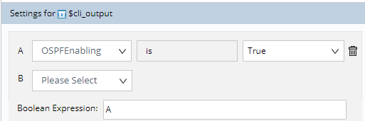

Display Conditions
(variable level)
Set conditions to control when to display a variable in a data view.
The default value - Always, indicating the current variable will be displayed under any circumstances.
If you select Condition Matched, you can customized the display condition for the selected variable:
Note: Whether a supporting variable of the current data view template can be selected to define the display conditions depending on the selected position. Both device-level variables and input variables apply to device positions; interface-level variables only apply to interface positions.
Note: Table-type and list-type variables cannot be used as conditions.

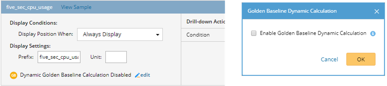

Dynamic Golden Baseline Calculation Enabled
Enable or disable the dynamic golden baseline calculation for the variable.
This is a sample screenshot:
Note: This setting only applies to parser variables.
