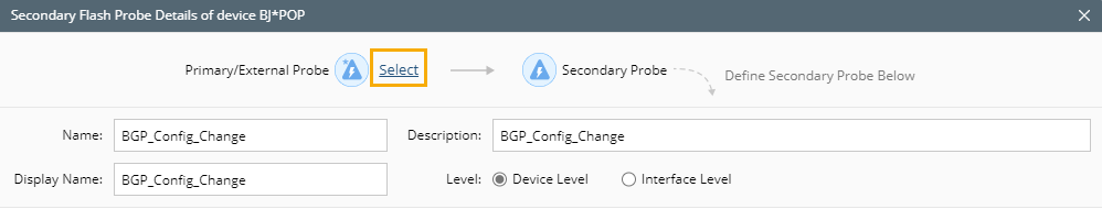

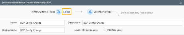

•To specify the desired primary flash probe(s) to trigger the secondary flash probe of the same device, simply select one or more primary flash probes from the Select section in Secondary Flash Probe Details.
1.Specify the desired primary flash probe(s) to trigger the secondary flash probe.
2.Click +Add Devices in the Add Flash Probes window.
Note: By default, only the the primary/external probe of the current device will be displayed.

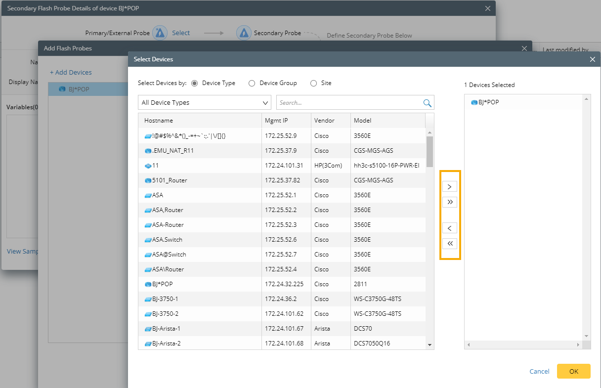

3.In the Select Devices window,
1)Click on the desired device, and click
to add it to the Devices Selected list. You can click
to deselect it. To add/remove all the devices to/from the Device Selected list , click
or

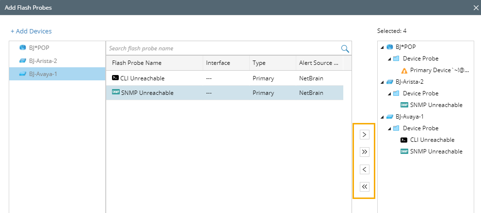

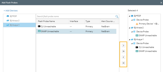

4.In the Add Flash Probes window,
1)Click on the desired flash probe, and click
to add it to the Selected list. You can click
to deselect it. To add/remove all the devices to/from the Selected list , click
or
