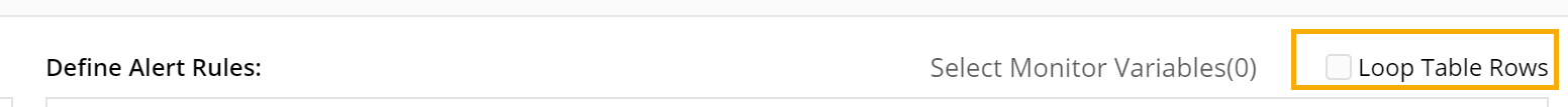

1.Check Loop Table Rows when defining the secondary probe.

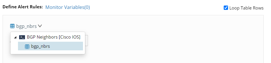

2.From the Define Alert Rules section, choose the table to be checked.

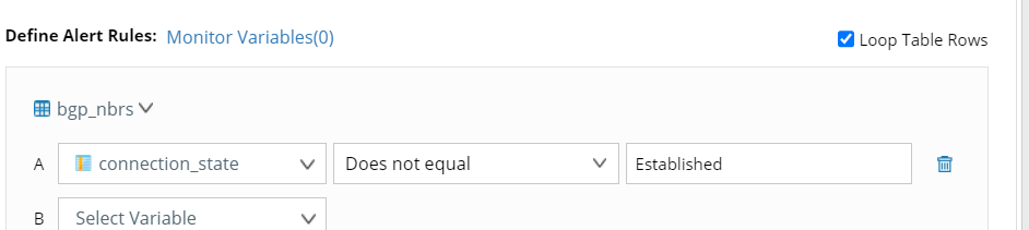

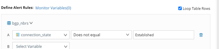

3.Define the columns and the corresponding statements to generate the alerts.
