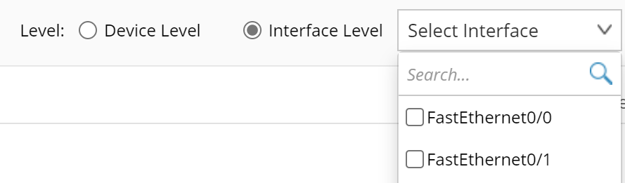

To capture device-level anomalies, such as CPU high, device config change, BGP neighbor flapping, select Device level.
To capture interface-level anomalies, such as interface flapping, interface error increase, select Interface Level. Flash probe can be configured at multiple interfaces of the same device. In this case, the system will check the selected interfaces one by one. If anomaly exists in any of the selected interfaces, alert will be generated and respective NIs will be triggered.

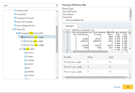

3)To define the variables that need to be monitored, click +Add to add variables.
When the level is set at device level: Choose Add Device Variable from the drop-down menu.  Search and locate the intended variable. Check it then click OK. Once a variable is added, you can also choose Add Compound Variable from the drop-down. menu.
When the level is set at interface level: Select Add Device Variable or Add Interface Variable from the drop-down.Search and locate the intended variable. Check it then click OK. Once a variable is added, you can also choose Add Compound Variable from the drop-down.

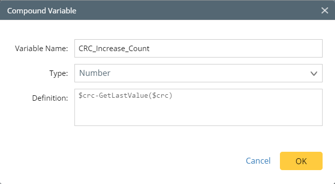

Compound variables are designed to perform bulk operations on multiple parser variables or use function calls to retrieve certain value. See Compound Variable for more details.
Example: CRC_Increase_Count = $crc-GetLastValue($crc)
In this example, compound variable is used to get the CRC error increase count.
