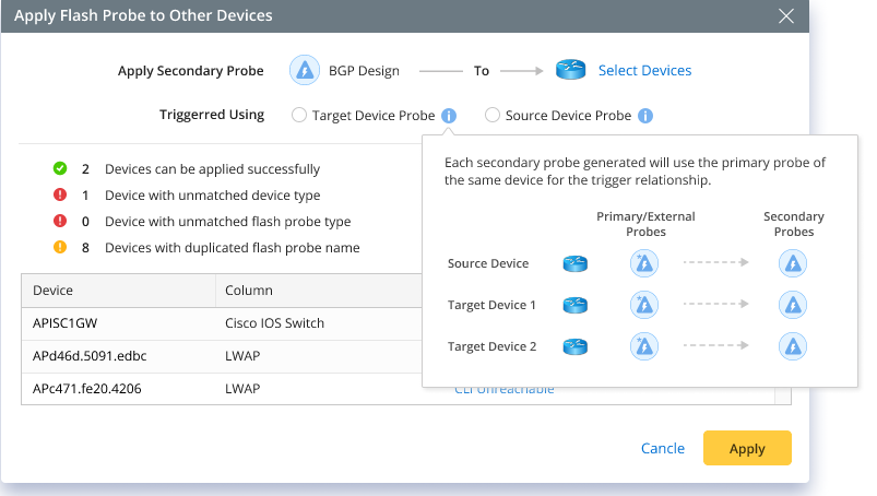

Applying Secondary Flash Probe to Other Devices
Like the primary flash probe, you can apply the secondary flash probe to other devices.

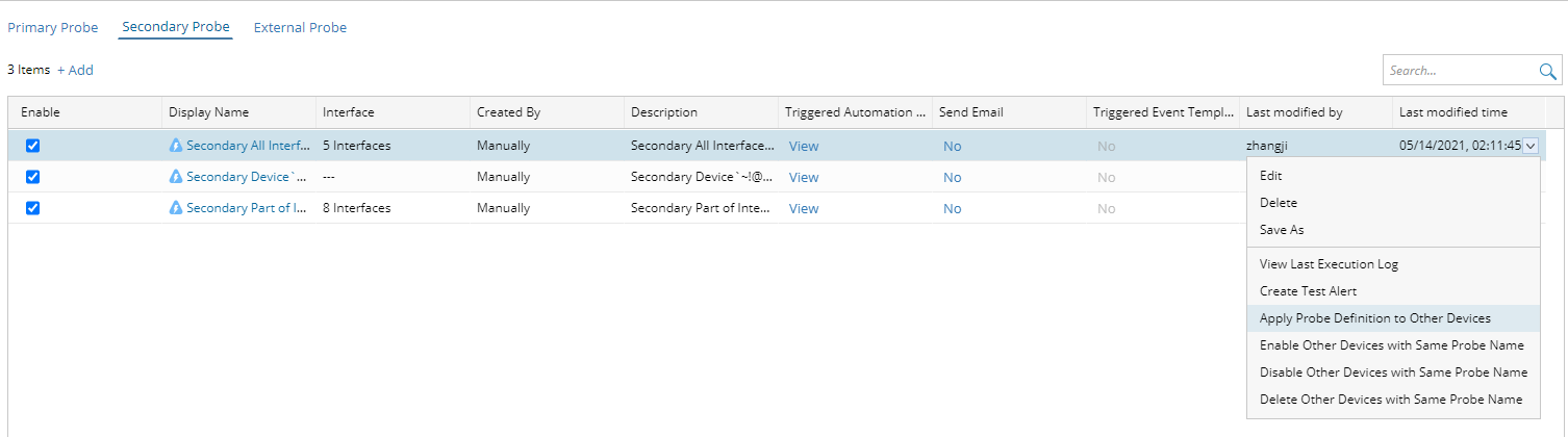

1.Select Apply Probe Definition to Other Devices in the drop-down menu of the desired secondary probe.
2.Select the device you want to apply this probe to.
3.Define Triggered Using.
Target Device Probe(Default): Using the primary probe/external probe of the same device to build the trigger relationship.
Source Device Probe: Enabling all the second probes to be triggered by the current device.
