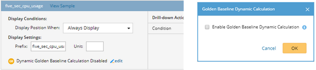

Dynamic Golden Baseline Calculation Enabled
Enable or disable the dynamic golden baseline calculation for the variable.
This is a sample screenshot:
Note: This setting only applies to parser variables.
