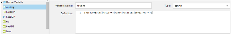

Beyond existing built-in variables and parser variables, the system supports compound variables in a data view template definition to organize multiple variables to represent complex network semantics.
Example: $routing = $hasBGP?$as:($hasOSPF?$rid:($hasISIS?$level:”N/A”))
The semantic of this compound variable means:
1.If $hasBGP is true, return the value of $as; if not, return the value of ($hasOSPF?$rid:($hasISIS?$level:”N/A”)).
2.If $hasOSPF is true, return the value of $rid; if not, return the value of $hasISIS?$level:”N/A”).
3.If $hasISIS is true, return the value of $level; if not, return ”N/A”.
For more detailed explanation about how to define a compound variable, refer to Compound Variable Properties.
