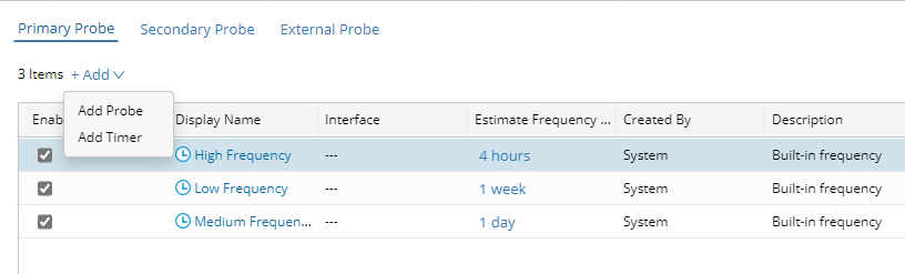

From the Adaptive Monitoring tab of Proactive Automation Manager, you can define the following three types of flash probes:
Primary Probe: Primary flash probes can be polled frequently at the desired frequency. IEv10.0 currently supports two types of primary flash probes:
oAdd Probe: Alert-based Flash Probe. It is triggered by device-generated anomaly.
oAdd Timer: Timer-based Flash Probe. It is triggered by timer and can be used for scheduled CLI/scheduled NI tasks.
