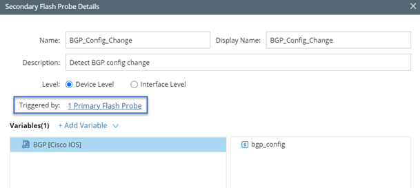

•Secondary flash probe can only be triggered by primary flash probe and they cannot run periodically.
•To specify the desired primary flash probe(s) to trigger the secondary flash probe, simply select one or more primary flash probes from the Triggered By section in Secondary Flash Probe Details.

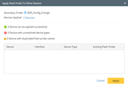

Like the primary flash probe, you can apply the secondary flash probe to other devices. Since the secondary flash probe needs to be triggered by primary flash probe, the system will check whether the targeting devices have the similar primary flash probe which can be used to trigger secondary flash probe. If not, the system will apply the primary flash probe to other devices first and then apply the secondary flash probe.
