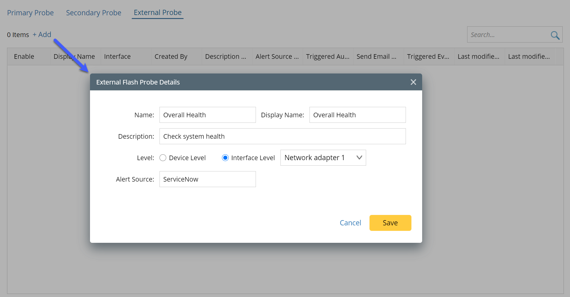

2.From the Adaptive Monitoring tab and on External Probe pane, click +Add an define an External Flash Probe in the External Flash Probe Details window:

▪Define trigger automation before the alerts are generated: You can define the flash probe by specifying the following information so the system will execute the network intent automation when the real alert is generated for the first time:
oName
oDisplay Name
oLevel
oAlert Source
