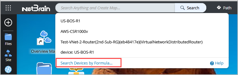

- Click the search bar and then select Search Devices by Formula from the drop-down list.

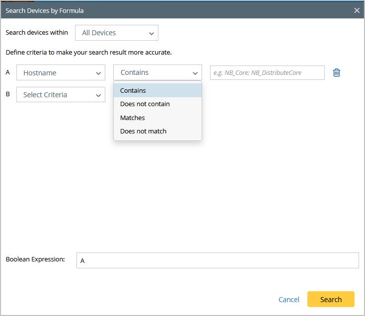

- Specify the scope to search for devices.

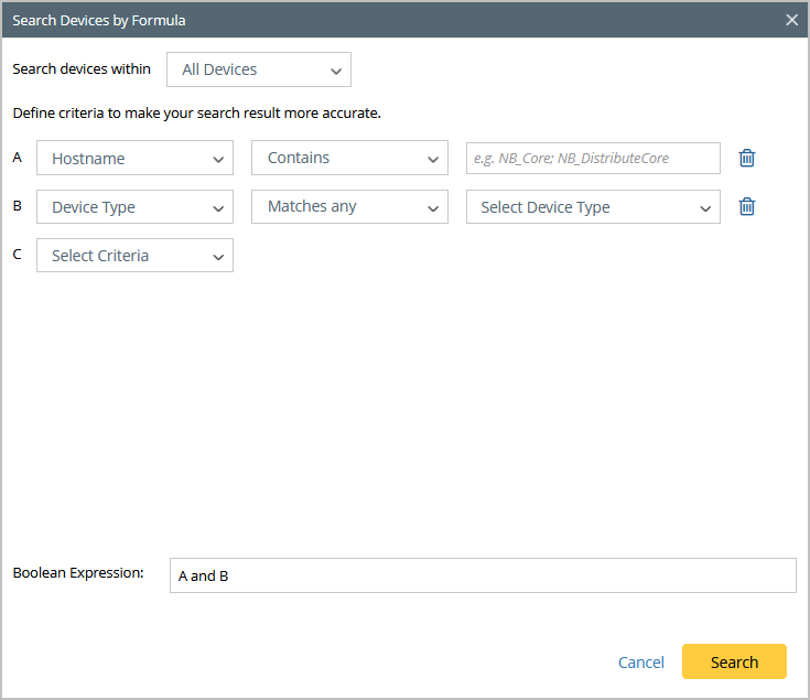

- Set search criteria A based on your needs:
- Select a data source and a property from the first drop-down menu.
- Select an operator from the second drop-down menu.
- Specify the value of the property that you selected.
- Repeat to set more conditions if required.
- Define the condition combination in the Boolean Expression field. For example, A and B.
In the Search Devices by Formula window, four match operators are available:
- Contains: The entered value is part of the contents in the first drop-down menu.
- Does not contain: The entered value is not part of the content in the first drop-down menu.
- Matches: The content in the first drop-down menu is complete the same as the specified value.
- Does not match: The content in the first drop-down menu is not complete the same as the specified value.

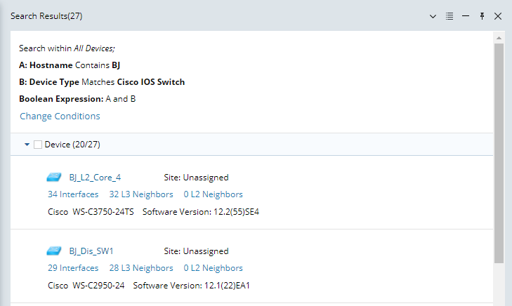

5. Click Search. The searched result is displayed as follows:
