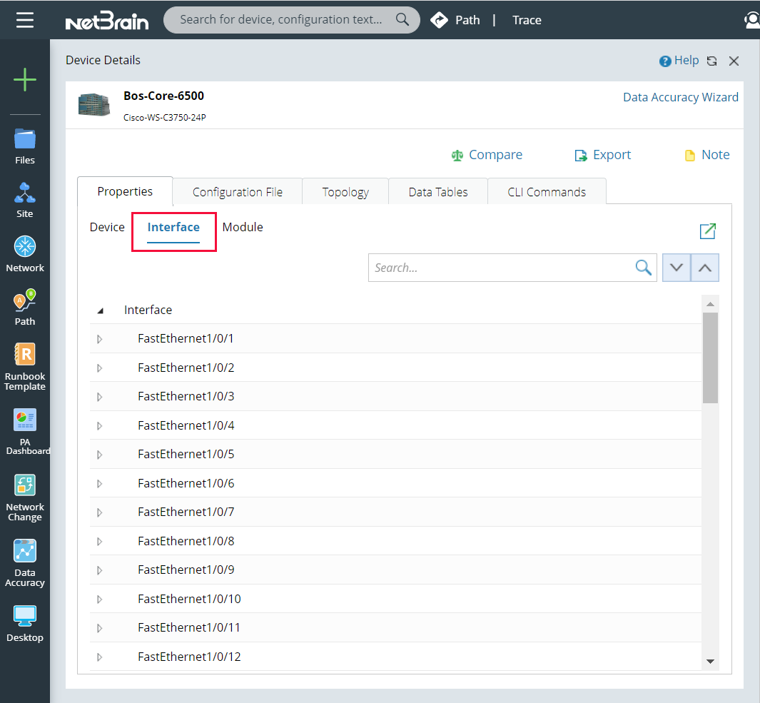

Both built-in and customized interface properties for different topology types are stored in the Global Data Repository. You can browse, modify, and export the values of interface properties for each device from the Device Details pane.
Modifying Interface Property Value in Device Details Pane
  1. In the Device Details pane, select the Properties > Interface tab. The interface properties are listed by interface type.
  2. Graphical user interface, text, application, email  Description automatically generated
  3. Click the  icon to pop out the interface details in a pop-up dialog.
  4. Click the icon to enter the editing mode and the icon to expand the interfaces you want to modify.
  5. Modify the values of the interface properties and click Save.
  6. Information Note: The values of some built-in interface properties cannot be edited.
