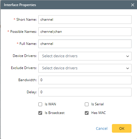

  3. Click Add and define the interface type as follows:
    1. In the Short Name field, enter the short name of the interface type.
    2. In the Possible Names field, enter all possible short or abbreviated names.
    3. In the Full Name field, enter the full name.
    4. In the Device Drivers list, specify the applied device drivers. You can use the Exclude Drivers option to exclude unnecessary drivers.
    5. (Optional) Enter the bandwidth or delay of the interface type.
    6. Select the supported interface type properties, such as Is Broadcast (whether support broadcast) , and Has MAC.
    7. Click OK.
