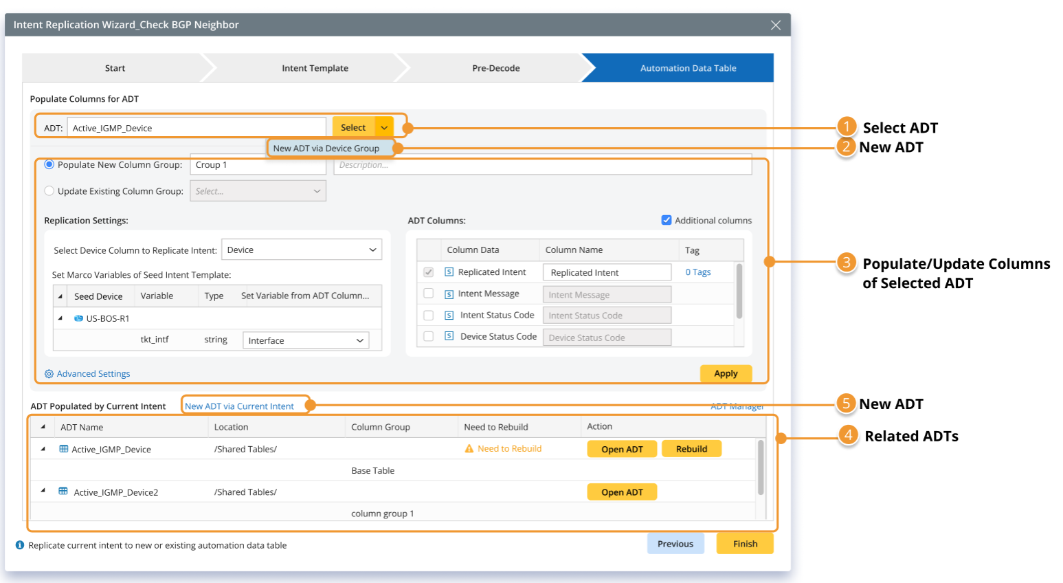

Operations on Automation Data Table in Wizard
In the Automation Data Table tab, power users can configure the following settings for ADT-based automation:
- Add New Column Group or Update Existing Column Group
- Create New ADT in Intent Replication Wizard
- Manage ADTs Associated with Current Intent
- Other Functions of ADT in Intent Replication Wizard
Note: To ensure that you will be guided to the Automation Data Table tab, select the Replicate Intent in ADT (Automation Data Table) option in the Start step. |
