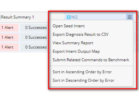

  • From the dropdown menu of an intent column in ADT View, the following operations can be performed as shown in the screenshot below:

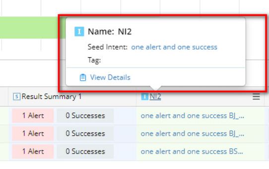

  • Click on the intent column header, the intent column name and the Seed Intent for replicating intents in this column, and tags (if any) are shown.
  • You can view the cell data and tip message of the cells in intent column by clicking on one entry.
