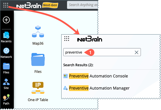

Opening Execution Tree
  1. Go to  on the desktop and search Preventive Automation Console, select the option from the results to open it.
  2. Click a device in the device list, and the Execution Tree will be activated.

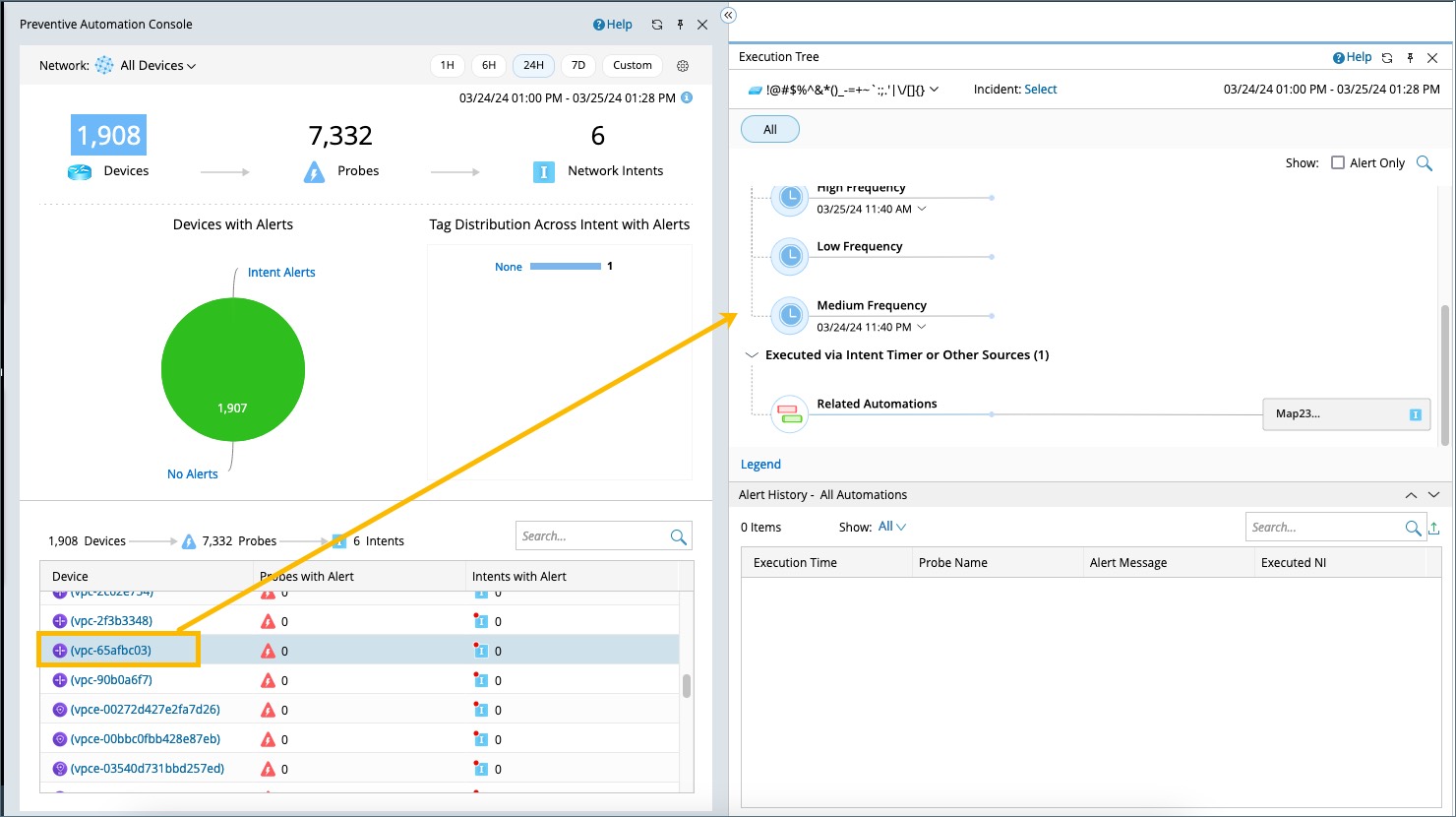

  3. A screenshot of a computer  Description automatically generated
    InformationInformation Note: The Execution Tree displays the preventive automation details of the selected device.
    Tip: To view the Execution Tree side by side with the map, you can click to hide the PA dashboard.
Viewing and Understanding Execution Tree
  • The Execution Tree will demonstrate all the probes and triggered intents for the selected device.
  • Graphical user interface, text, application  Description automatically generated
    # Meaning
    1 You can select the latest or the historical execution results of the probe from the drop-down menu.
    2 The tags of the network intent can be used to narrow down to the interested network intents.
    3 You can quickly switch between different devices by using the drop-down menu.
  • The lower window shows the alert history during the selected time range.
  • Information Tip: You can click on the probe icon and network intents on the Execution Tree, and the results in the Alert History window will be filtered based on your selection.
