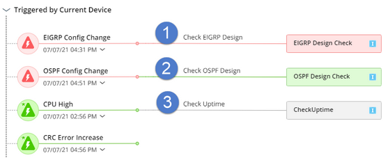

In the Execution Tree, each Flash Probe connects to multiple Triggered Intents, meaning that the respective intents will be triggered when the associated Flash Probe generates the respective flash alert.
Different color codes are used to differentiate various types of execution results:
TimelineDescription automatically generated with medium confidence
#UI DescriptionMeaning
1Rectangle and connecting line in redThe error status code is generated by the Network Intent.
2Rectangle and connecting line in greenThe execution result for the Network Intent is normal.
3Rectangle and connecting line in greyThe status of Network Intent is unknown. Either it was not executed during the selected time range, or no status code defined to identify the status.
When you click and open the specific triggered automation, the Network Intent window in view mode will appear on screen.
