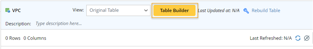

In the My Tables folder, create a new table and give it a name that describes its purpose. For instance, named it as VPC.
Click on the Table Builder button to open the Automation Data Table Builder window.

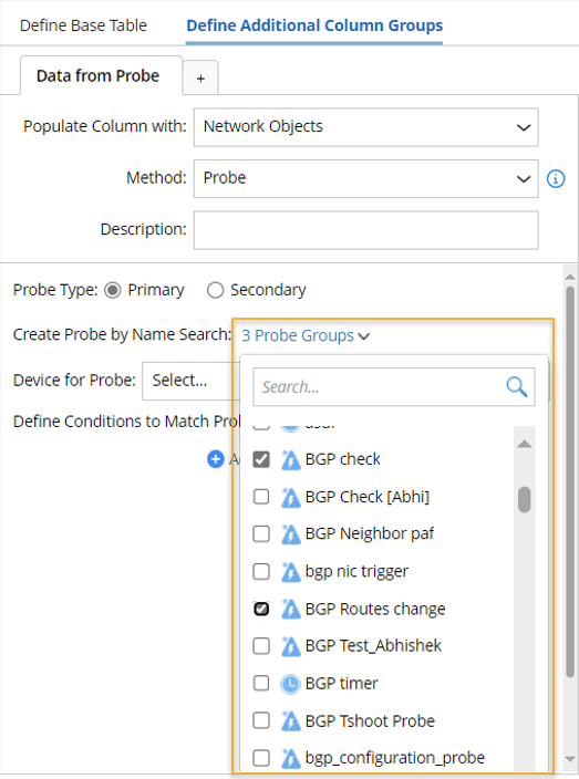

Add a new column group and select the Network Objects > Probe method to build a group table.
Select Primary as the probe type and drag the built-in field Probe to the column group.
Choose a probe group from the drop-down menu located next to the Create Probe by Name Search field.

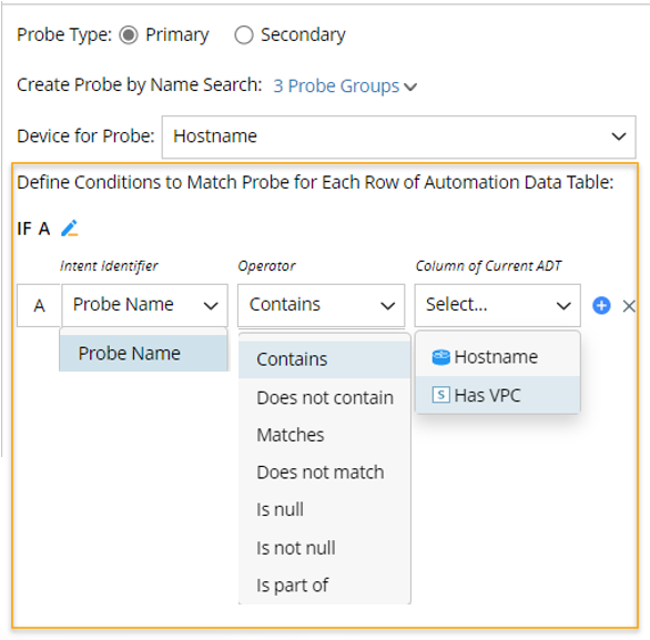

- In the Device for Probe field, select a device column from base table to associate the probes with devices in this column.
Define conditions: Click Add Condition, then define conditions to match probe property with base table column data of the current ADT.

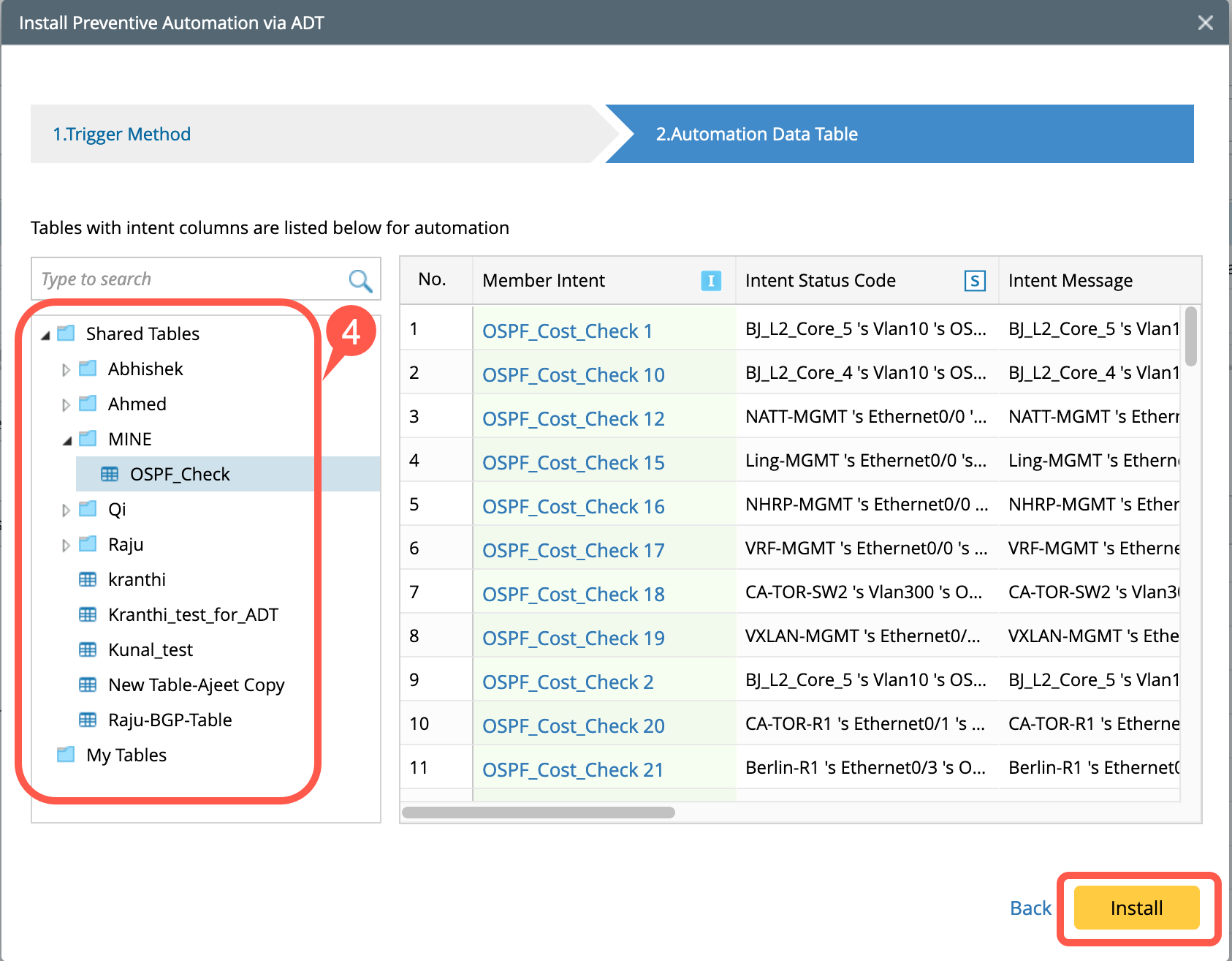

- Click on +Install Automation to open a pop-up window Install Preventive Automation via ADT.
- Select one of the Trigger Method to configure and click on Next located at the bottom right side of the window.
Search for the predefined ADT table in the list and click on Install.
NOTE: ADT Tables with intent columns are only listed for automation.
- The automation item will be created by the system and appear in the list.
