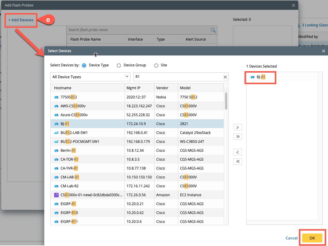

    4. Select the Default Goup or add a new group using +Add Group located at the top right corner of the window and then click on +Add Probe to popup another window Add Flash Probes.
    5. Click on +Add Devices which will further another window Select Devices, choose the required devices and select > and then OK.
    6. Now all the device probes will appear in the Add Flash Probes window, select the applicable probe and select > and then click OK.
    7. The selected probe now appears in the Manage Looking Glass probe window and then back in Add Looking Glass probe window, select it and click OK.

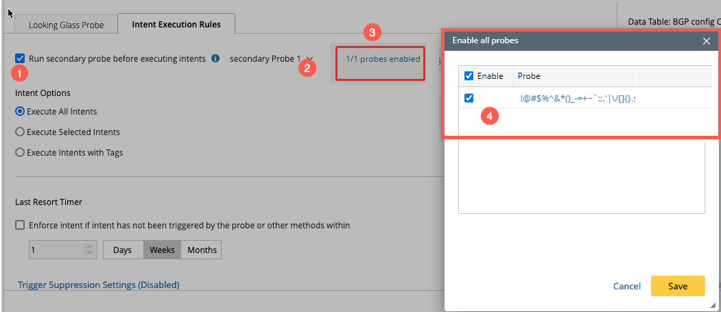

In case, if you want to check some symptoms before looking glass probe triggering Intents, then you can use the secondary probe to improve the accuracy. And only if the Selected Secondary Probe generates an alert, the selected Intents will be executed further.
For example: You have a critical ADT table to manage critical WAN links and use the command show ip route  on looking glass devices to identify the critical route change. If any route change happens on looking glass device, it will trigger the intent execution. In some cases, the route change on looking glass devices does not necessarily be the WAN link of the ADT table affected. And in this case, you can configure the secondary probe on the WAN link devices using the command show ip route to verify the route entries on the WAN link devices are indeed affected.
To enable the secondary probe:
  1. Check in the Run secondary Probe before executing intents to enable secondary probe column selection.
  2. Select the secondary probe column from the drop down menu.
  3. Click X/X probes enabled to pop-up the window Enable all probes.
  4. Check in all the secondary probes required as per your use case and click Save.
Information Note: The Secondary Probe may be triggered by different sources. So, the secondary probe should be associated with the Looking Glass Probe triggering the execution of Intents. If the Secondary Probe is triggered by any other Primary Probes, even if there is an alert, the Intents will not be triggered.

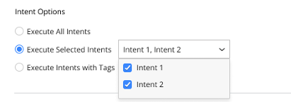

Configure Intent to be triggered:
For each row in the ADT table, intents will be executed after matching with the data. The configuration options for executing Intents are as follows:
  • Execute All intents: Executes all Intents.
  • Execute Selected Intents: Executes specified Intent Columns, one or multiple Intent Columns can be selected
  • Execute Intents with Tags: Based on the tags present in all intent columns, corresponding intent tags are listed for the user to select. One or more tags can be chosen here.
