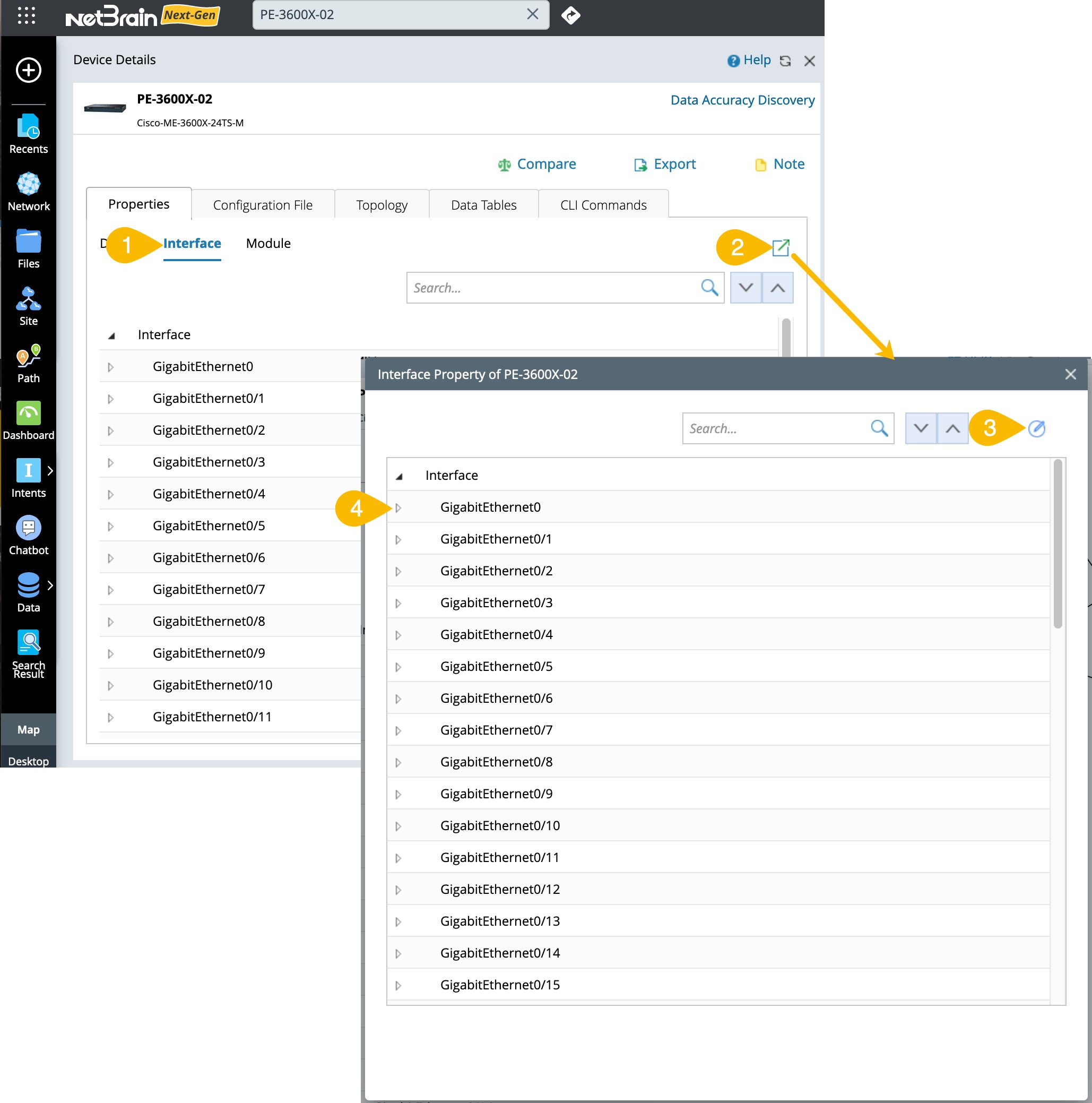

  1. In the Device Details pane, select the Properties > Interface tab. The interface properties are listed by interface type.
  2. Click the  icon to pop out the interface details in a pop-up dialog.
  3. Click the icon to enter editing mode.
  4. To expand the interfaces you want to modify, open the interface by clicking .

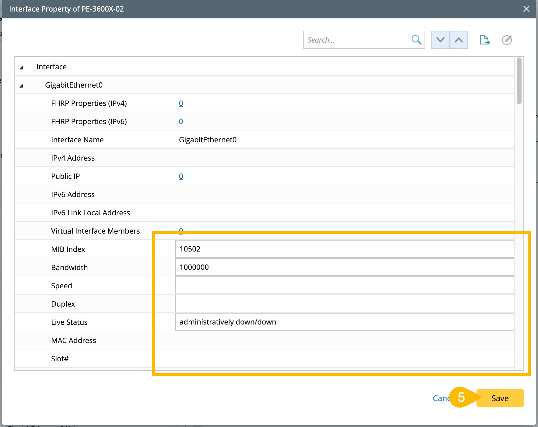

  5. Modify the values of the interface properties and click Save.
  6. Information Note: The values of some built-in interface properties cannot be edited.
