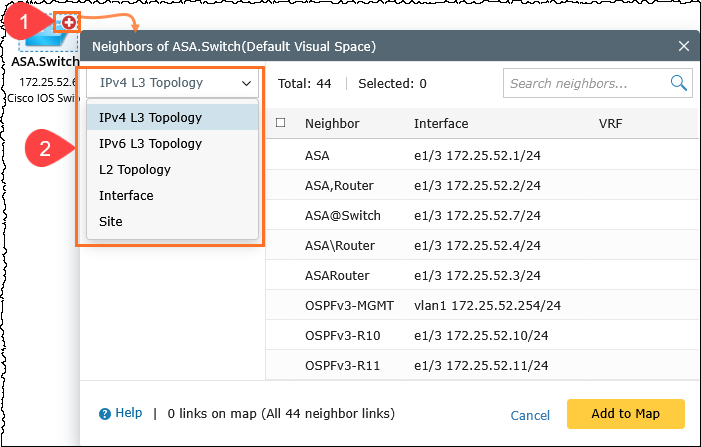

  1. Click the icon attached to the target device on your map.
    Information Tip: You can manually resize the extent neighbor window by dragging any of the four corners of this window.
  2. Select a neighbor type from the drop-down menu to filter neighbors:

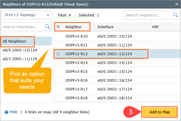

    Note: Enter an IP address or parts of an IP address in the left pane's search bar to refine or locate interfaces.
  3. Choose one or multiple neighbor devices, then click Add to Map. Alternatively, double-click All Neighbors to include all listed neighbor devices on the map.
    Note: Use the right pane's search bar to find specific neighbor devices or sites.
  4. Repeat the above steps to extend the neighbors for more devices.

Neighbor Types
The table below lists all neighbor options and their corresponding interfaces for you to select when extending neighbors.
Table 1 - Selectable Interface for Different Neighbor Devices
Neighbor OptionInterface
IPv4 L3 TopologyIncludes all Layer 3 interfaces of the target device or the Layer 3 PE interfaces of the target MPLS cloud configured with IPV4.
IPv6 L3 Topology
(only available for extending neighbors of a device)
Includes all Layer 3 interfaces of the target device configured with IPv6.
L2 Topology
Includes all Layer 2 interfaces of the target device.
L3 VPN Tunnel
(only available for extending neighbors of the device with IPsec/GRE VPN configured)
Includes the outside interface of the target device.
InterfaceIncludes all interfaces (including both Layer 3 and Layer 2 interfaces) of the target device or MPLS cloud.
SiteIncludes all device interfaces connected with the site or all PE interfaces of an MPLS cloud connected with the site.

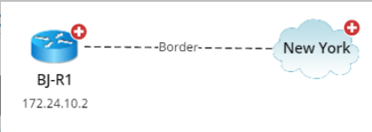

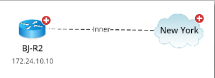

Connectivity Between a Device and a Site
When you extend neighbor devices for a site, the connectivity on a map might be one of the following:
Table 2 - Neighbor Devices (for Site) Connectivity on Map
Connectivity on MapDescription
Graphical user interface
Description automatically generated with low confidenceThe device is an inner device of this site, indicating that it is not connected to any devices from other sites.
A picture containing table
Description automatically generatedThe device does not belong to the site and is connected to a device (BJ-R1) within the site.
A picture containing graphical user interface
Description automatically generatedThe device is a border device of this site, indicating that it is connected to devices of other sites.
