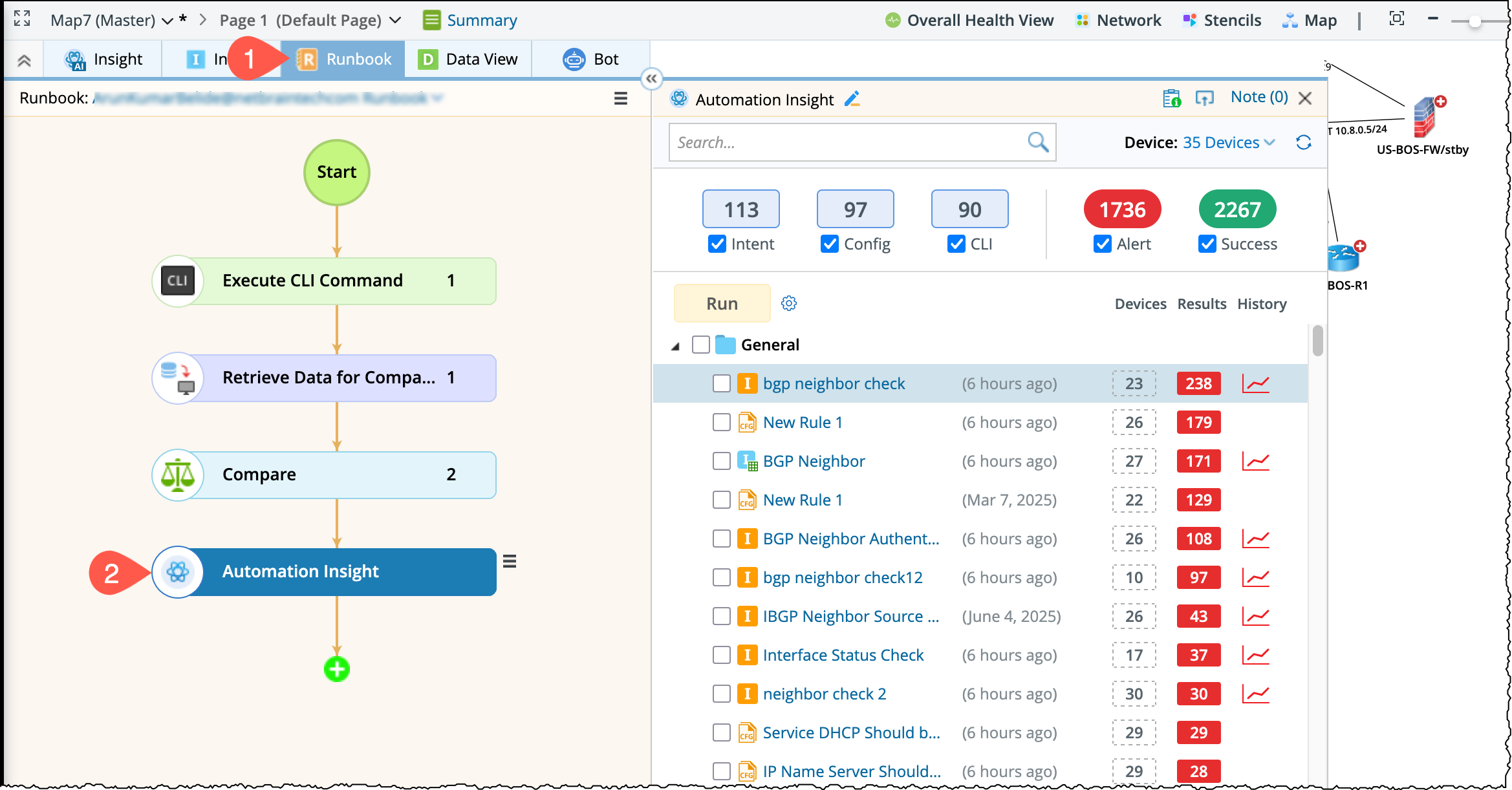

  1. On the current map, navigate to Runbook pane.
  2. Add the Automation Insight node to the Runbook. Once added, the Insight node pane will display automation results of all map devices. Automations are automatically grouped by category for easier navigation.

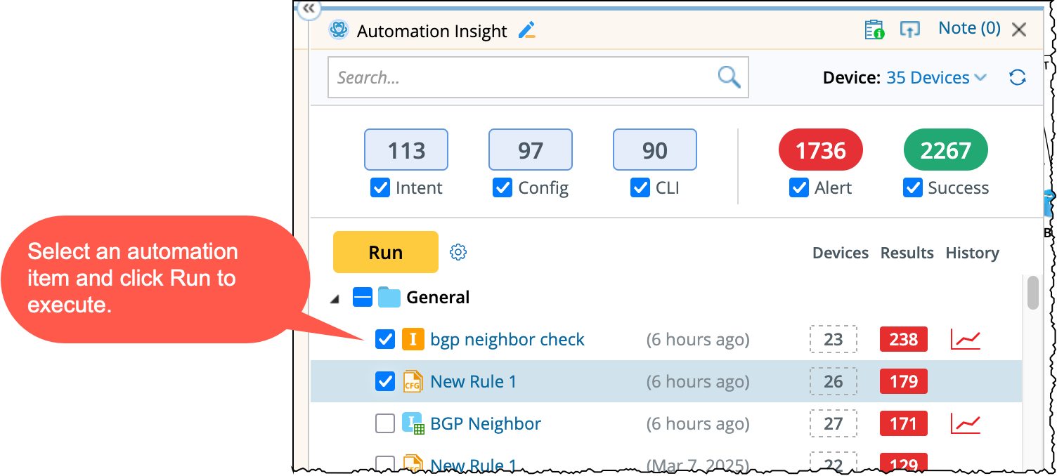

    Tip: To execute an automation directly, select the check box of an intent and click Run.

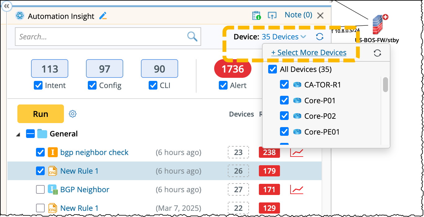

  3. If necessary, You can manually select non-map devices to view their automation results as well.

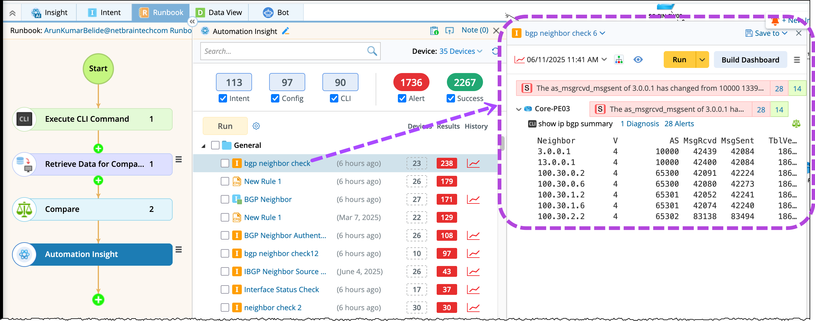

  4. Click on an automation item to view detailed results.
    Information Tip: For more information on reviewing the automation results, Refer to View AI Results on AI Insight Tab for more details.
