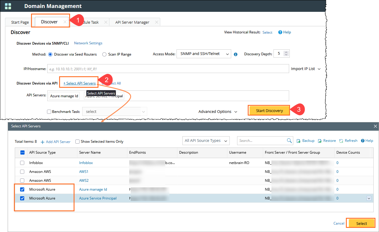

Follow these steps to discover Azure networking resources via APIs:
Follow the steps below to discover the network data model in a NetBrain domain:
  1. In the Domain Management > Start Page, click Discover.
  2. Click Select API Servers to select the Azure API Server you just created.
  3. Click Start Discovery to start the Azure discovery. You can run the discovery task manually or schedule a discovery task to discover Azure resources.

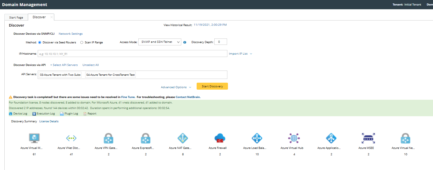

  4. Wait till the discovery finishes. The number of discovered objects will be displayed.
