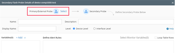

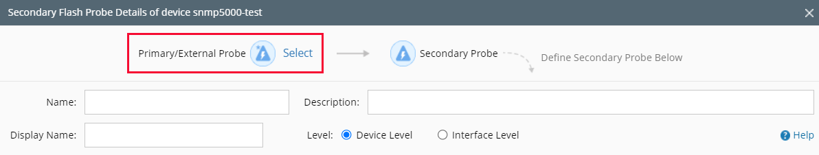

  • To specify the primary flash probe(s) to trigger the secondary flash probe of the same device, select one or more primary flash probes from the Select  section in  Secondary Flash Probe Details.

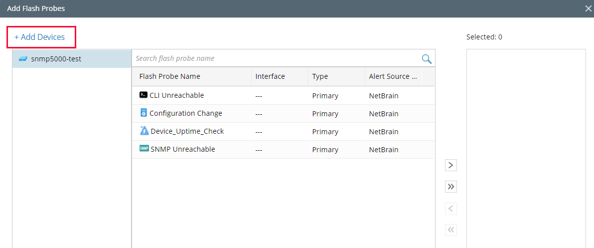

  1. Specify the desired primary flash probe(s) to trigger the secondary flash probe.
  2. Click +Add Devices in the Add Flash Probes window.
    Graphical user interface  Description automatically generated
    Information Note: By default, only the primary/external probe of the current device will be displayed.

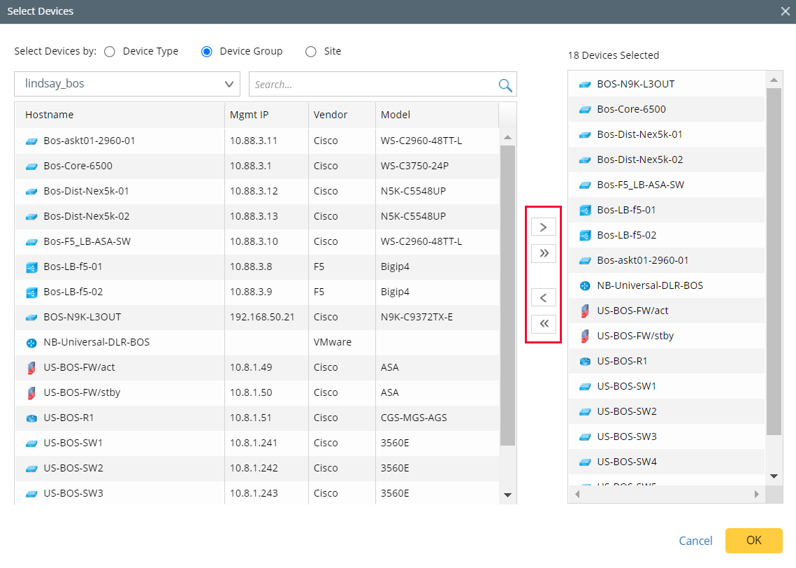

  1. In the Select Devices window,
    1. Click on the desired device and click to add it to the Devices Selected list. You can click  to deselect it. To add/remove all the devices to/from the Device Selected list, click  or.
    2. Click OK.

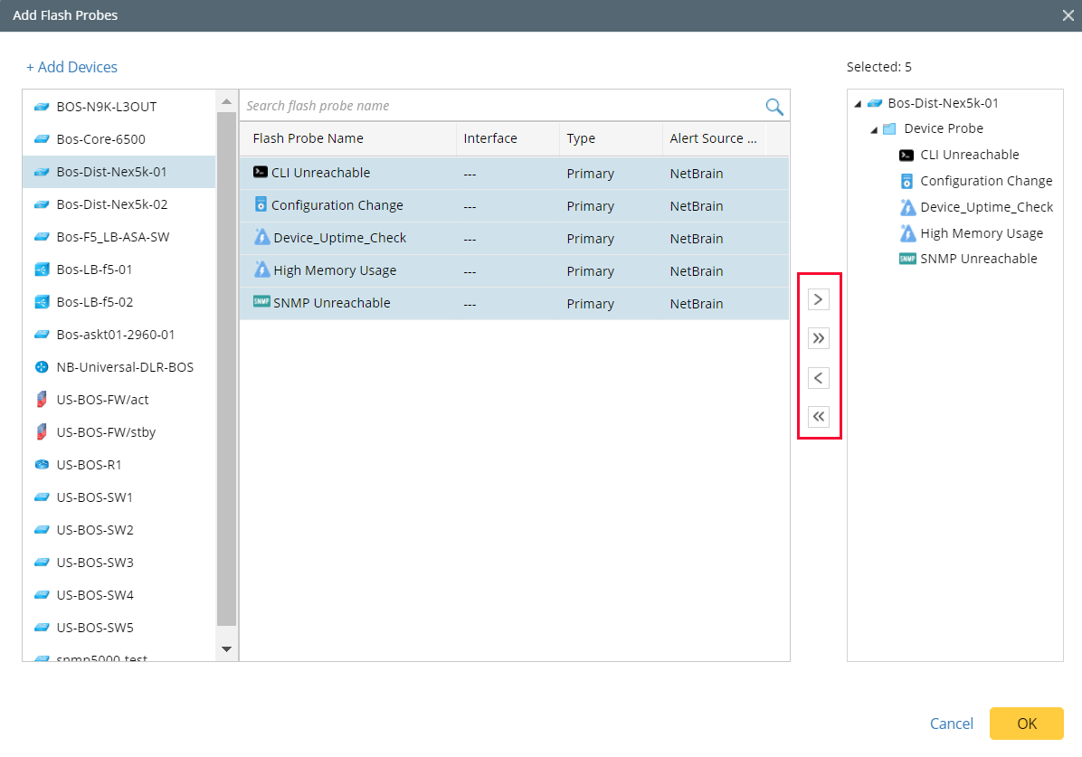

  1. In the Add Flash Probes window,
    1. Click on the desired flash probe and click to add it to the Selected list. You can click  to deselect it. You can also use Ctrl + cursor to select multiple items and click  or to select to unselect them all.
    2. Click OK.
  1. Define Secondary Flash Probe Details.
    Information Note: Most of the operations and settings are the same as Primary Flash Probe. Please see Defining Flash Probe for more details.
