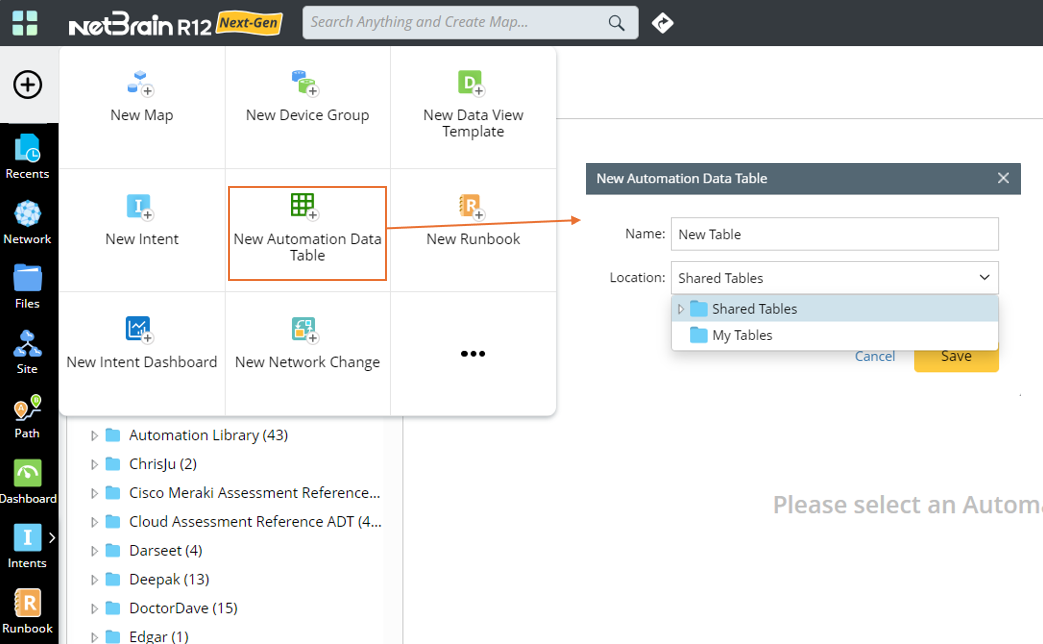

  1. Go to the   menu, then click New Automation Data Table widget. In the popup dialog, define table name and select location to store the table.

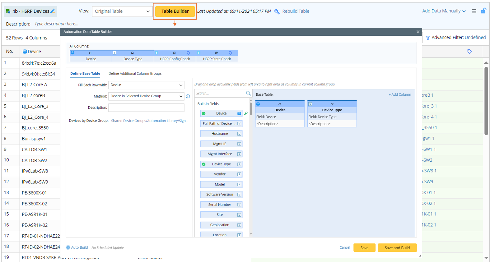

  2. Go to Table Builder> Define Base Table to build a base table containing data fields to include automation asset data to be used.

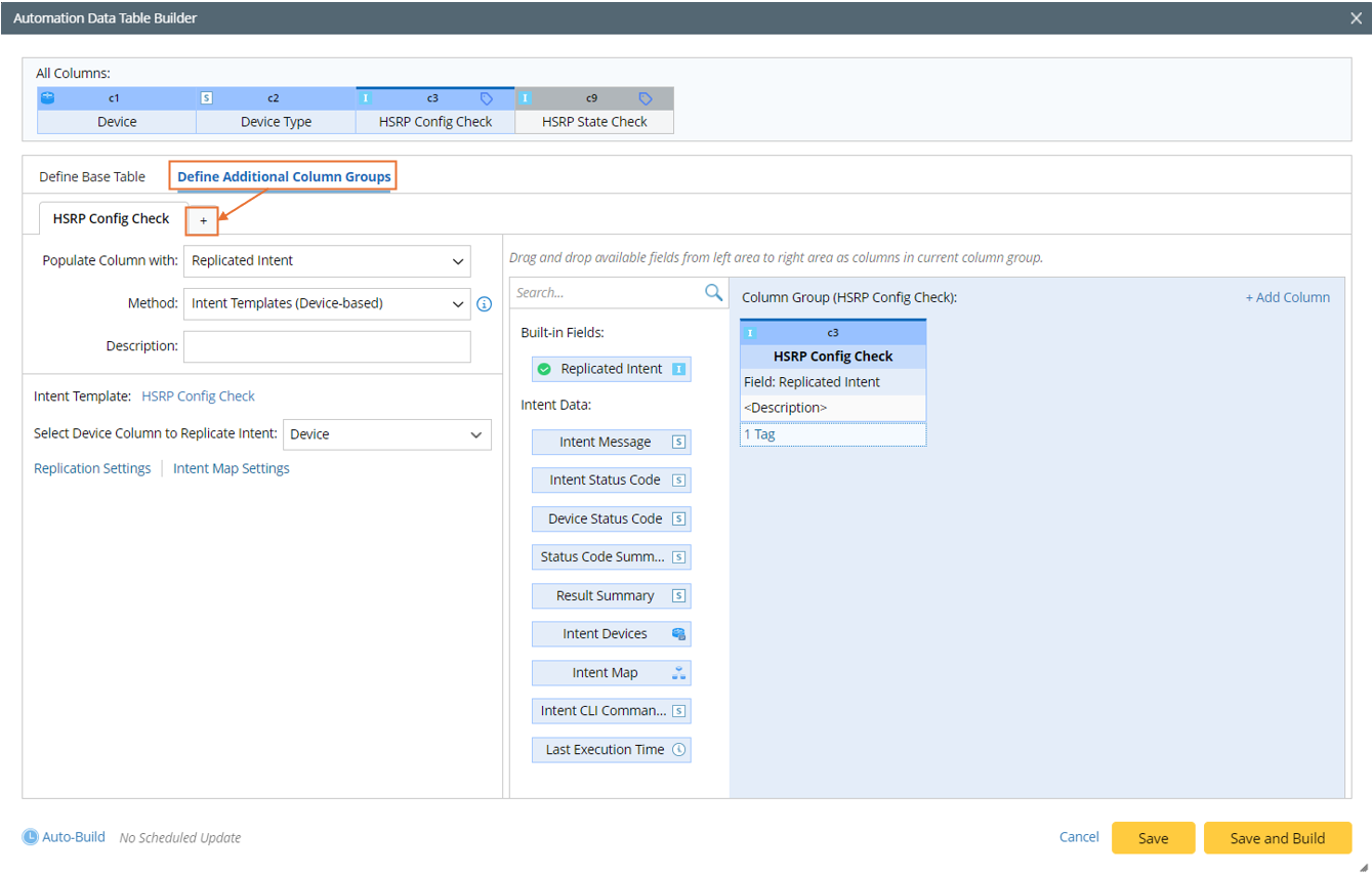

  3. Go to Table Builder > Define Additional Column Groups, then click  to create column groups to enrich the base table data.

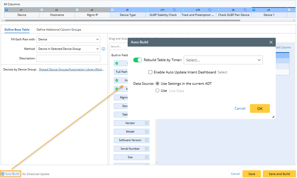

  4. Go to Automation Data Table Builder (Auto-Build) to schedule to update ADT data periodically.

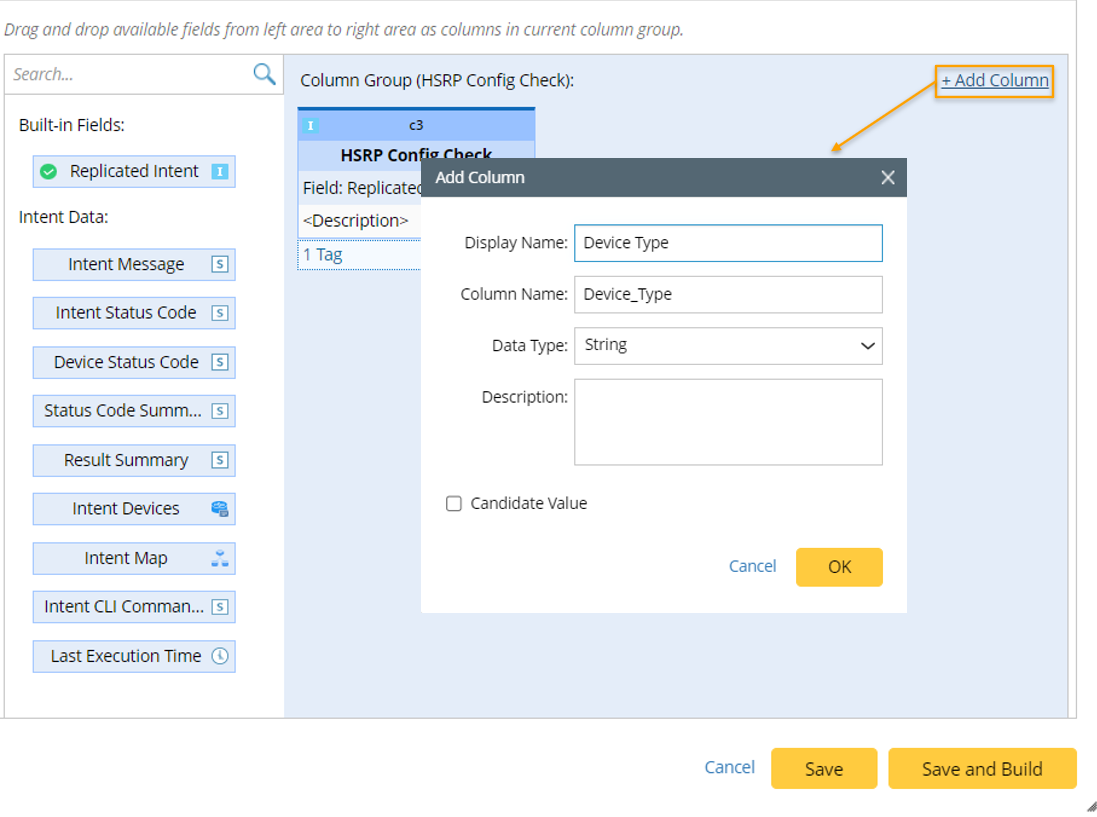

  5.  Go to Automation Data Table Manager (Add Column) to manually add or adjust the table data.

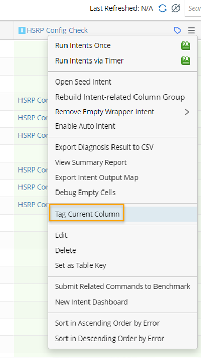

  6. Go to Automation Data Table Manager, then create tags for the automation column/map column from Tag Current Column of the drop-down menu. The tags can be applied to filtering the intents used for TAF, PAF, Bot, Auto Intent or Follow-up Intent.
