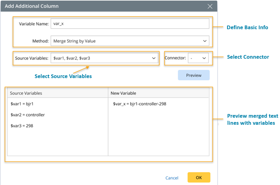

Merge String by Value
Using this method, selected source variables will be merged via connectors “-“, “ _”, “ ;”, “,”, “|”, “Space”, and “\n” to create new variable.
  • Define basic information about the new variable.
  • Select sources variables (variables from the original table) to be merged.
  • Select connector to link the source variables into one.
  • Preview the final output.
Example of Merge String by Value
Merge 3 variables into 1 by the selected connector.
From the source table, select the following variables, then connect them with connector ‘-’.
  • $vendor (string) = Cisco IOS
  • $version (string) = 15.4(2)T4
  • $reload_reason = Unknown reason
In the final output table, the following variable will be created.
$var_x = Cisco IOS-15.4(2)T4-Unknown reason

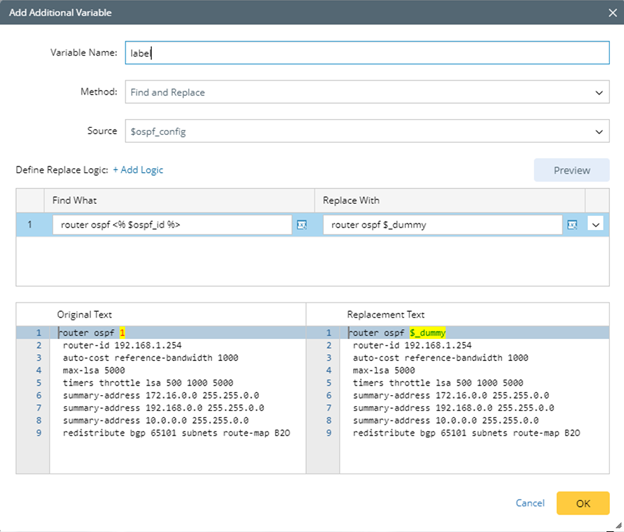

Find and Replace
This method can help to replace special text with $_dummy to convert the variable into a config template. In Find and Replace method, variable template can be inserted in the form of <%$var%> in the ‘Find What” text for search, which can save the trouble of inputting regular expression.
  • Select one source variable to locate the text lines having characters to be replaced. If variable is inserted (in the current use case, variable $ospf_id is inserted), it will be converted to variable template for finding texts to be replaced.
  • Input the replacement text.
  • Define match type:
    • Match Whole Word: The search results will only match if the whole word matches.
    • Match Case: Make the search terms case-sensitive.
    • Use Variable Template: Enable this function to convert a variable into variable template for searching texts to be replaced.

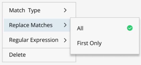

  • Replace Matches: Select to replace all matched characters or only replace the first matched one.
  • Regular Expression: Define where regular expression will be applied.
 Example of ‘Find and Replace’ Method.
This Example shows how to replace special text with $_dummy to make the variable into a config template.
  • Parse variables - $interface, $description, $ip_address, $intf_config (using Parse Lines) in configuration file.
  • Click Add Additional Variable, then In the Edit Additional Variable window, select the Find and replace method, then replace the variables $interface, $description, $ip_address (these variables will be converted to corresponding variable template ‘<%$var%>’) with the input texts. The final replacement results can be previewed in the bottom area.
