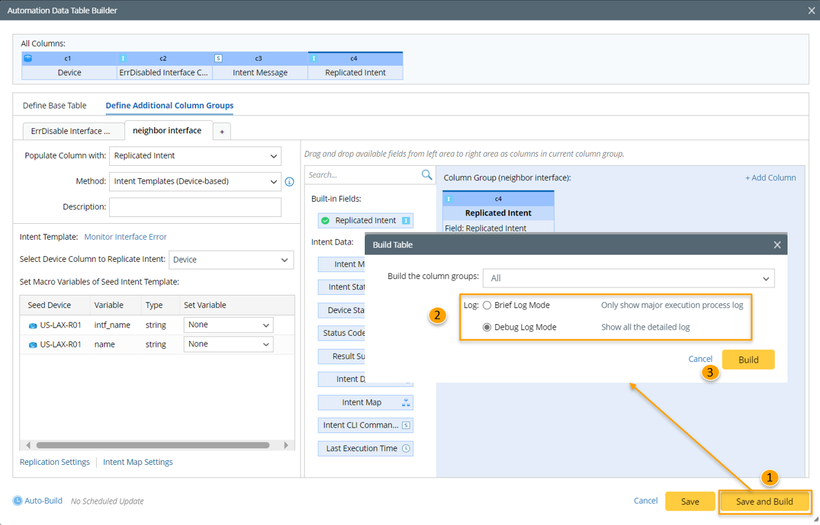

Configure Mode for Building ADT Log
ADT is an essential resource in PDAS and may contain huge amount of intents which generate logs. As more and more logs are generated, the process of building ADT becomes time-consuming. To solve this problem, two modes (Production/Debug mode) are provided to define the log that will generated when building ADT data.
Follow the steps below to define the building mode in Table Builder.
  1. Click the settings icon next to the Save and Build button.
  2. Select the types of logs that will be generated.
    • Brief Log Mode (default): If this mode is selected, only major execution process logs are generated, and log for intent replication are not generated. In this mode, the amount of created logs is reduced.
    • Debug Log Mode: All debug logs (including intent replication logs) are generated. In this mode, all detailed logs are shown for butter troubleshooting.
  3. Click OK to save the settings. The settings will take effect after you click the Save and Build button.

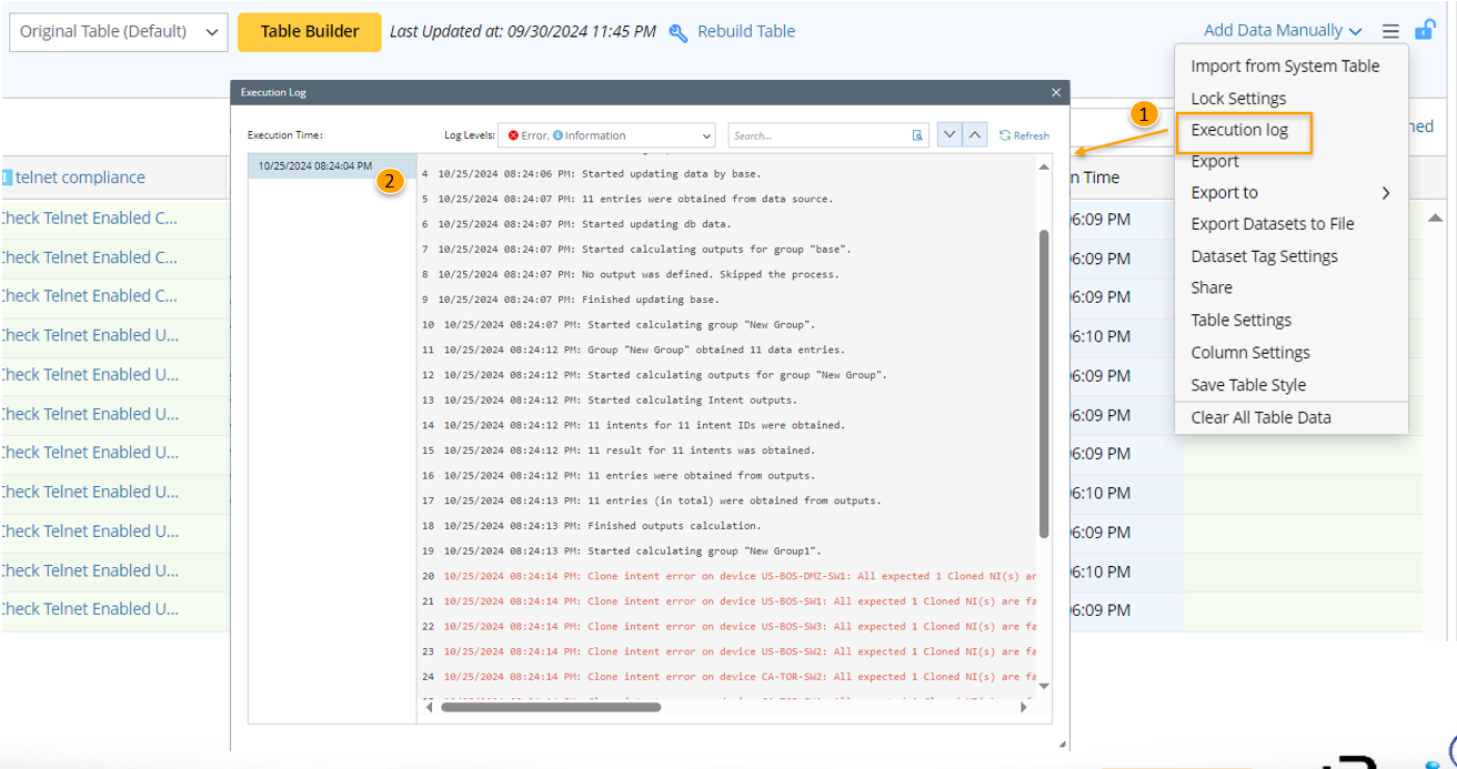

View ADT Execution Log
After the ADT has been built, you can check the ADT execution log in ADT Manager.
  1. Select the ADT from the left folder structure to check its Execution Log. Then click Execution Log from the drop-down menu.
  2. Select an execution time in the left pane. The execution log starting from the selected execution time will be displayed in the right pane.
    Information Note: Task ID is shown in execution log and each task ID is also a link to intent replication log details.
