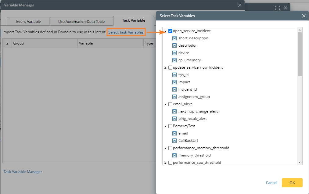

- On the Task Variable tab, click Select Task Variables.
- You can select the required task variables based on group in the Select Task Variables dialog.
Note: Only the task variables selected on the Task Variables tab can be used in intent diagnosis. And such task variables can be called in home intent and all its follow-up intents where the variables are used. - Click OK after selecting the task variables.

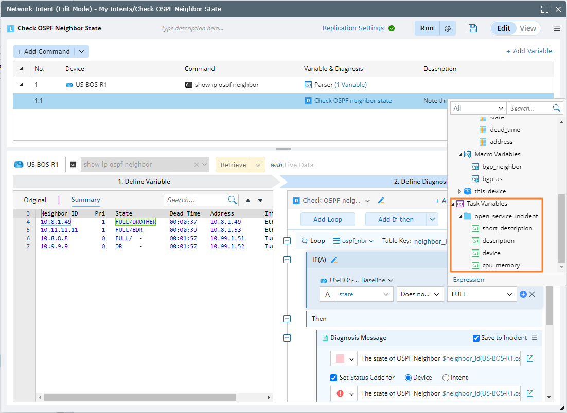

- In the Define Diagnosis tab, the selected task variables are displayed for you to use.

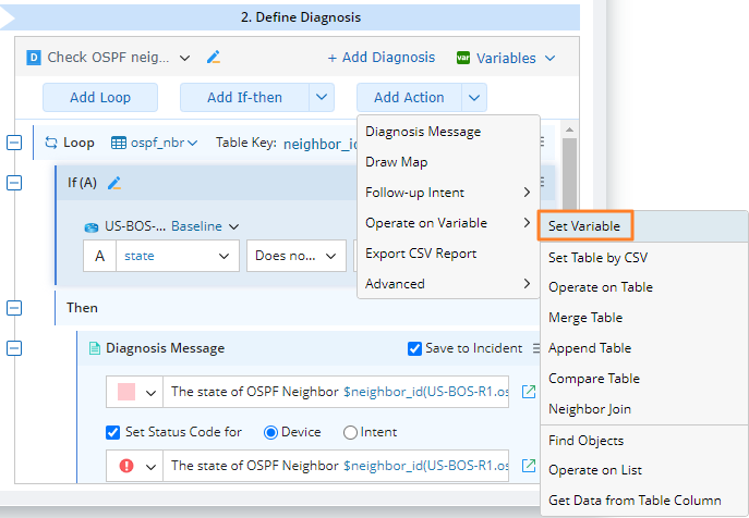

- (Optional) You can add Set Variable logic to assign value for the selected task variables.

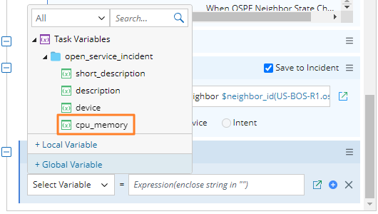

- Add Set Variable logic.
- Select a task variable and assign value for it.
